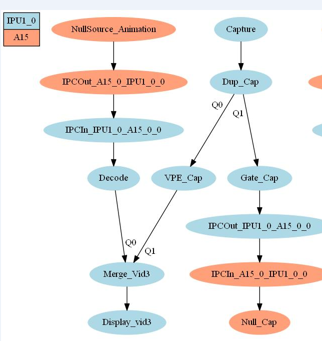

can VPE convert SYSTEM_DF_YUV422I_UYVY to SYSTEM_DF_YUV420SP_UV ?
my link design as following:
NullSource_Animation (A15) -> Decode -> Merge_Vid3 -> Display_vid3
Capture -> Dup_Cap -> VPE_Cap -> Merge_Vid3
        Dup_Cap -> Gate_Cap -> Null_Cap (A15)
As animation output is SYSTEM_DF_YUV420SP_UV fomat, so i need convert Capture to SYSTEM_DF_YUV420SP_UV,
my capture output is 720x480 , format is SYSTEM_DF_YUV422I_UYVY,  and screen size is 1920x720, so i add the VPE link setting as following:

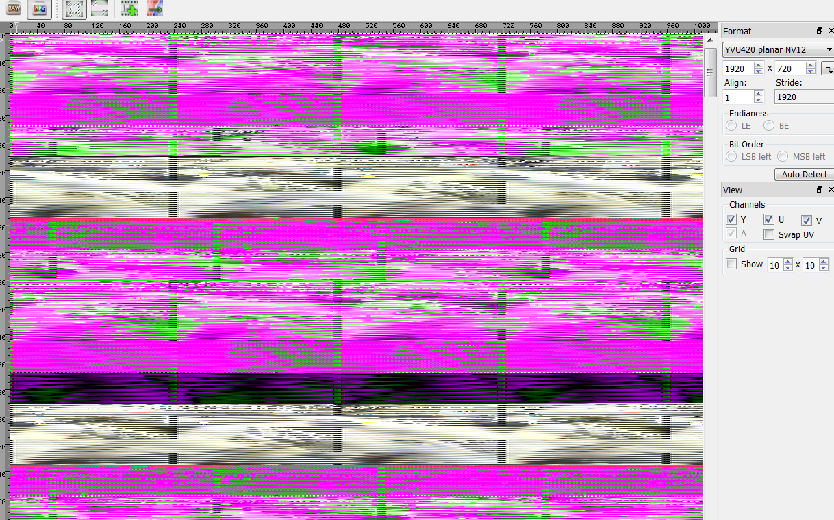

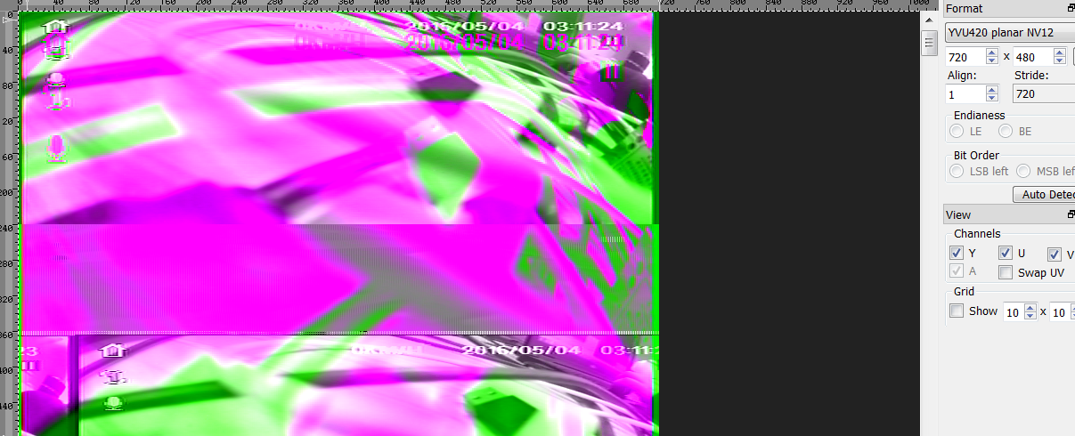

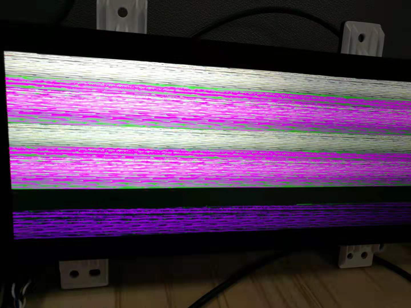

animation can show well, but when i switch to capture it not show correct. why?
if just only capture without animation, VIP link work well. whether the index of chParams and outParams are wrong ?
