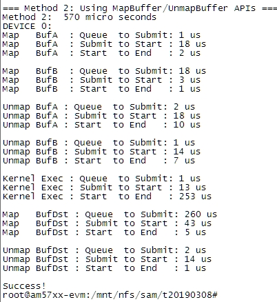

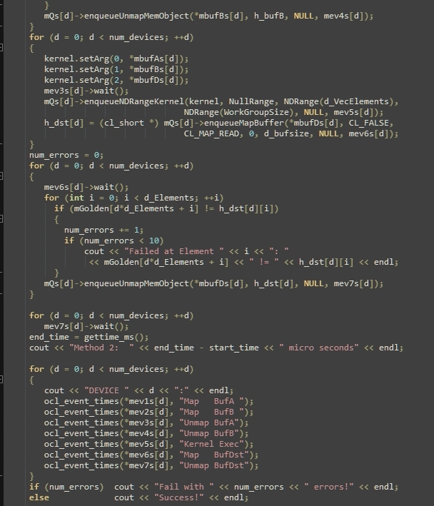

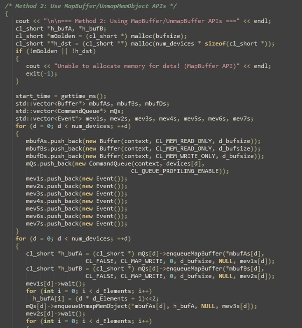

Customer follow SDK provided vecadd example, got result as below, Buffer map/unmap time consumption is very big compare to kernel execution.
please refer below snapshot, is is the nature? or how to improve it?
