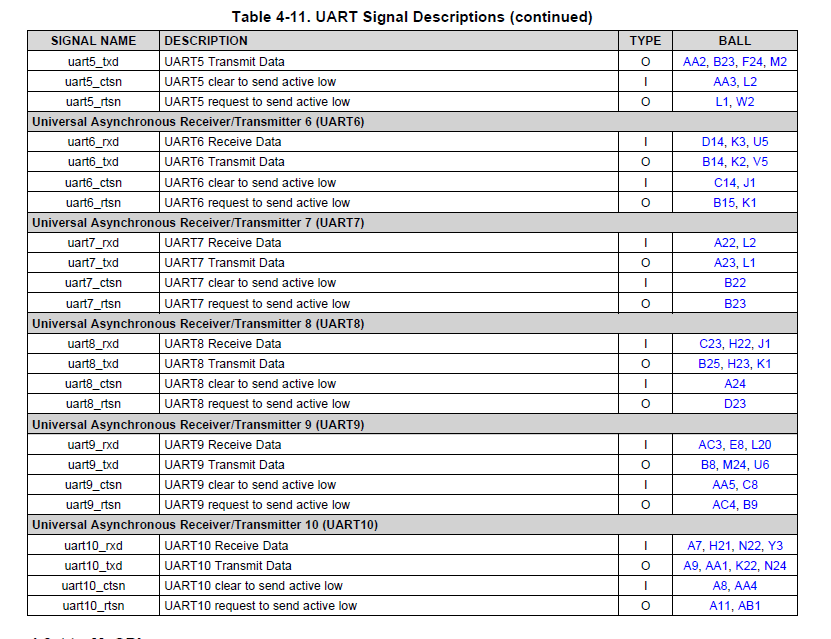

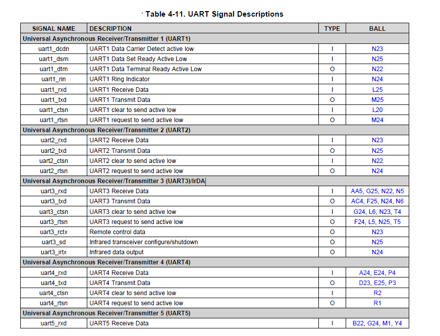

Which one refers to pr1_uart0 of the ten uarts in this picture? I really can not understand this in the AM570x TRM Rev. H.
None of these. These all are standard UARTs. PRU UART pins are listed in Table 4-24 of the AM570x Datasheet Rev. D (page 93).
Thanks U for your reply,and your answer has resolved my issue.To be honest,it's my first time to use the PRU UART,and i just want to get started as soon as possible,can U give me some suggestions so that i can use the PRU UART of AM5708.
