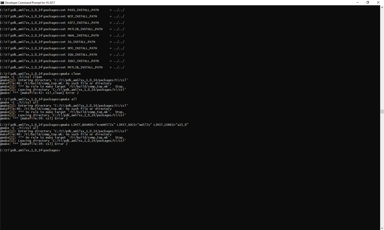

  • I am unable to get JTAG working with the X15 on the Linux VM I used to compile USB_DevMsc_mmcsd. I am, however, able to get JTAG working with the X15 on Windows. But in Windows I am unable to compile the example project because the pdkProjectCreate.bat script is completely empty. I have tried installing the PDK in C:\ti, as well as my user home directory and the project, create script was blank in both instances.

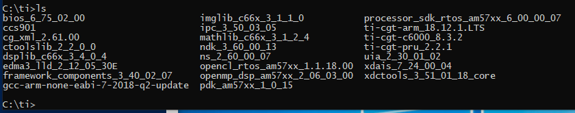

  • Yes, we can use the Windows environment to flash over JTAG and I understand that the X15 is not directly supported by TI. The X15 is not our problem, it is that the script to create CCS9 projects is an empty file. I have tried rebuilding the SDK with the results below.
    pdksetupenv.bat was the first command run with the output being the long set of "set <...>_PATH = ../../" commands. Again, our issue is not JTAG or the BeagleBoard. Our issue is creating the USB_DevMsc_mmcsd project in Windows. Why is the pdkProjectCreate.bat file a blank file? We have RTOS 6.0 and CCSv9 as seen here:
  • I have installed the version of the Processor SDK RTOS that you are using and don`t see pdkProjectCreate.bat as a blank file.
    the other thing that I don`t understand is why you are manually setting the PATHs manually to components or why gmake clean and gmake all is being called in the setting up of the USB examples. The driver libraries and CSL are already built.
    All you need to do is install CCSv9 in C:\ti\ccs901. Open CCSv9 and complete component discovery in Processor SDK RTOS as described in getting started guide
    then Open command prompt:
    cd processor_sdk_rtos_am57xx_6_00_00_07
    setupenv.bat
    cd ..\pdk_am57xx_1_0_15\packages
    pdkProjectCreate.bat AM572x evmAM572x little usb all
    This should generate the necessary USB examples in MyExmaples folder in the pdk_am57xx_1_0_15\packages folder. Import projects in CCS and build to generate the USB MSC binary needed for flashing EMMC
