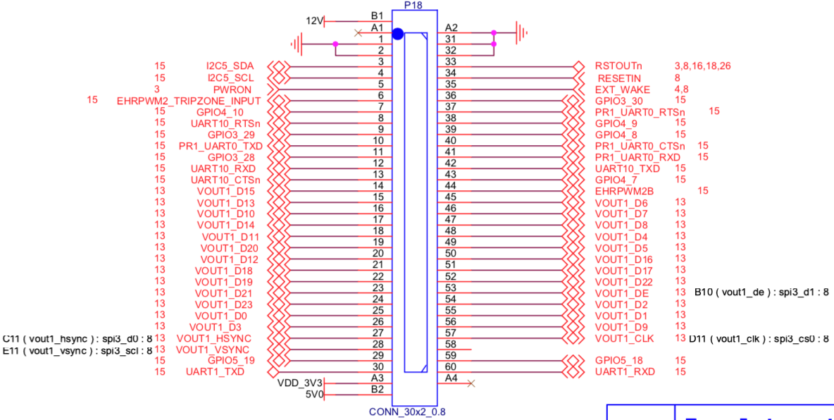

I enabled SPI 3 IOSet 2 in a pinmux file, created a custom board and rebuilt the pdk. I was able to generate SPI examples and use the custom board to run the examples. The two examples I ran were the "MCSPI_BasicExample_idkAM572x_c66xExampleProject" and "MCSSPI_Loopback_idkAM572x_c66xExampleProject". The only thing I modified was the board to point to my custom board.
I monitored the following exposed pins on P18:
  • spi3_sclk : E11
  • spi3_d1 : B10
  • spi3_d0 : C11
  • spi3_cs0 : D11
These examples didn't seem to modify the outputs on the exposed pins. I didn't see the clock signal or see the CS0 oscillating when running the code.
I would like to generate the "SPI_TestApplication" to see if it outputs to the exposed pins, but this project doesn't get generated when I run.
    • spi3_sclk : E11
    • spi3_d1 : B10
    • spi3_d0 : C11
    • spi3_cs0 : D11
    The first pin that needs to toggle is spi3_cs0. I would suggest you to dump McSPI3 pinmux, PRCM and module registers and check if you will have the expected values.

    I'm watching the following pins:
     Can you please let me know what I am doing wrong? I would like to see the SPI Loopback example working on SPI 3.

    Can you please let me know what you think might be the problem with getting SPI 3 working on IOSet 2?
  • Andre Henriques said:
    SPI3_SCLK: 786440
    SPI3_D1: 786440
    SPI3_D0: 786440
    SPI3_CS0: 393224
    SPI3_CS1: 327694
    Andre,
    My request was to make register dump of below McSPI3 pinmux registers:
    CTRL_CORE_PAD_VOUT1_VSYNC
    CTRL_CORE_PAD_VOUT1_HSYNC
    CTRL_CORE_PAD_VOUT1_DE
    CTRL_CORE_PAD_VOUT1_CLK
    If the above quoted registers values corresponds to these McSPI3 registers, then your pinmux settings are not correct. For example:
    CTRL_CORE_PAD_VOUT1_VSYNC[3:0] VOUT1_VSYNC_MUXMODE value should be 0x8 (spi3_sclk), while you have 0x0 (vout1_vsync), check AM572x TRM, Table 18-1397. CTRL_CORE_PAD_VOUT1_VSYNC.
    I would suggest you to put a breakpoint right after padConfig_prcmEnable() function and explore SPI3 pinmux registers from the CCS menu. What values you have at that point?
    Also note that below AM572x pins you need to use for this McSPI3 pinmux:
    E11 - VOUT1_VSYNC.spi3_sclk
    C11 - VOUT1_HSYNC.spi3_d0
    B10 - VOUT1_DE.spi3_d1
    D11 - VOUT1_CLK.spi3_cs0
    Pavel

    I have below SPI3 registers settings:
    MCSPI_SYSCONFIG = 0x308
    MCSPI_SYSSTATUS = 0x1
    MCSPI_IRQSTATUS = 0x0
    MCSPI_IRQENABLE = 0x1
    MCSPI_MODULCTRL = 0x1
    MCSPI_CH0CONF = 0x380403FC
    MCSPI_CH0STAT = 0x2E
    MCSPI_CH0CTRL = 0x200
    MCSPI_TX0 = 0x31
    MCSPI_RX0 = 0x31
    I have also observed that only pin AF9 (spi3_d1) is used, and AE9 (spi3_d0) is not used in this test.
    Pavel

    Pinmux settings
         HW_WR_REG32(0x4A009800, 0x00000002); // Start SPI3 L4PER Clock Control
         HW_WR_REG32(CSL_MPU_CORE_PAD_IO_REGISTERS_REGS+CSL_CONTROL_CORE_PAD_IO_PAD_VOUT1_VSYNC,0x000C0008); // SPI3_SCLK (SPI3_IOSet_2)
         HW_WR_REG32(CSL_MPU_CORE_PAD_IO_REGISTERS_REGS+CSL_CONTROL_CORE_PAD_IO_PAD_VOUT1_DE,0x000C0008); // SPI3_D1 (SPI3_IOSet_2)
         HW_WR_REG32(CSL_MPU_CORE_PAD_IO_REGISTERS_REGS+CSL_CONTROL_CORE_PAD_IO_PAD_VOUT1_HSYNC,0x000C0008); // SPI3_D0 (SPI3_IOSet_2)
         HW_WR_REG32(CSL_MPU_CORE_PAD_IO_REGISTERS_REGS+CSL_CONTROL_CORE_PAD_IO_PAD_VOUT1_CLK,0x00060008); // SPI3_CS0 (SPI3_IOSet_2)
    Even running your code directly, the SPI3 IOSET 1 does not succeed the test for me. Do you know how this could be possible? I have a freshly flashed SD Card with a fresh install of Processor Linux and RTOS 06.01.00.08 using a fresh install of CCS 9.2.0.00013.
  • Andre,
    Pinmux settings
    These pinmux is not the same as mine:
    //IOSET1
        HW_WR_REG32(CSL_MPU_CORE_PAD_IO_REGISTERS_REGS+CSL_CONTROL_CORE_PAD_IO_PAD_VIN1A_DE0,0x000C0008);
        HW_WR_REG32(CSL_MPU_CORE_PAD_IO_REGISTERS_REGS+CSL_CONTROL_CORE_PAD_IO_PAD_VIN1A_FLD0,0x000C0008); //d1
        HW_WR_REG32(CSL_MPU_CORE_PAD_IO_REGISTERS_REGS+CSL_CONTROL_CORE_PAD_IO_PAD_VIN1A_HSYNC0,0x000C0008); //d0
        HW_WR_REG32(CSL_MPU_CORE_PAD_IO_REGISTERS_REGS+CSL_CONTROL_CORE_PAD_IO_PAD_VIN1A_VSYNC0,0x00060008);
    Please align to my pinmux settings and try again.
    Pavel
  • Sorry for any misunderstanding. I tried this for both the SPI3 IOSet 2 settings which I shared along with your code which used SPI3 IOSet 1 as shown below.
        HW_WR_REG32(CSL_MPU_CORE_PAD_IO_REGISTERS_REGS+CSL_CONTROL_CORE_PAD_IO_PAD_VIN1A_DE0, 0x000C0008); // SPI3_SCLK (SPI3_IOSet_1)
        HW_WR_REG32(CSL_MPU_CORE_PAD_IO_REGISTERS_REGS+CSL_CONTROL_CORE_PAD_IO_PAD_VIN1A_FLD0,0x000C0008); // SPI3_D1 (SPI3_IOSet_1)
        HW_WR_REG32(CSL_MPU_CORE_PAD_IO_REGISTERS_REGS+CSL_CONTROL_CORE_PAD_IO_PAD_VIN1A_HSYNC0,0x000C0008); // SPI3_D0 (SPI3_IOSet_1)
        HW_WR_REG32(CSL_MPU_CORE_PAD_IO_REGISTERS_REGS+CSL_CONTROL_CORE_PAD_IO_PAD_VIN1A_VSYNC0,0x00060008); // SPI3_CS0 (SPI3_IOSet_1)
    In both scenarios, the SPI3 does not pass the McSPIVerifyData test. All other SPI peripherals do pass the test.
