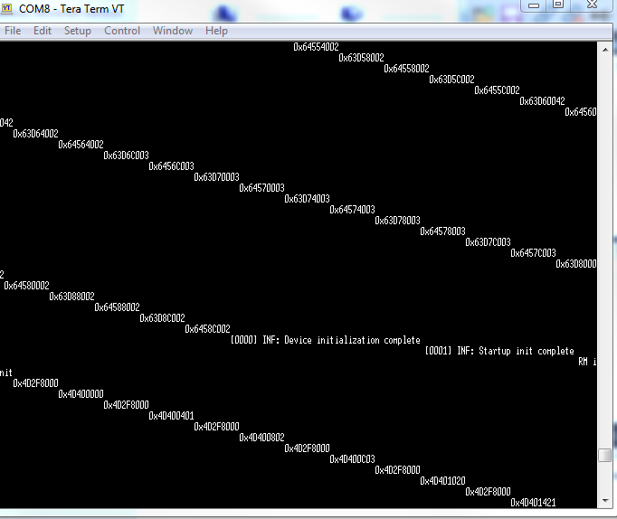

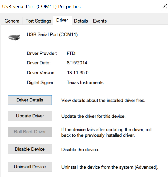

I have some problems regarding the UART on new my TMDX654IDKEVM. When initially booting the board from the provided SD card (int SD card boot mode), I get the following output when connecting to the first of the 4 available com ports from Tera Term:
A baud rate of 115200 is selected. It does appear from here that some information is received successfully, while other information is just Hexadecimal numbers. Is this the expected operation when initially booting from the SD Card(just giving it power)?
I went on to upload and test the ETH/CANgateway application project provided with the SDK. Everything works as expected in terms of operation of the CAN communication, Ethernet socket communication as well as printing to the CCS console with the printf() call in utils_prf.c of the gatewayapplication. However nothing is observed from the UART in Tera Term. The only data received over the UART is when initially uploading the program to the R5-core, with the observation seen below:
And once again only a few information is "readable":
Now as mentioned when running the application, nothing gets observed from Tera Term, only the output to the CCS console is observed correctly. According to my understanding of the software, UART instance 0 is configured as part of the application and should print to the UART AND the CCS Console from function call Utils_consoleprintf(). The UART_print() function call is thus not observed, although the printf call is.
Could you please provide some assistance in getting the UART connection fixed?

  • Hi Johnny,
    Sorry for the late response.
    The hex dump output is expected when booting up the platform, but it obviously is not what we want to see typically.
    The uart port which you connected to is not the debug console of U-Boot or Linux.
    I don't use Window/Tera-term but minicom in Linux, so I cannot explain why the first UART port Tera-term connected to is no the U-Boot/Linux debug console. In Linux, I would see the same hex output on the 3rd UART port with minicom in Linux.
    You might want to try to connect to each of the 4 UARTs to see which one is the U-Boot/Linux console.

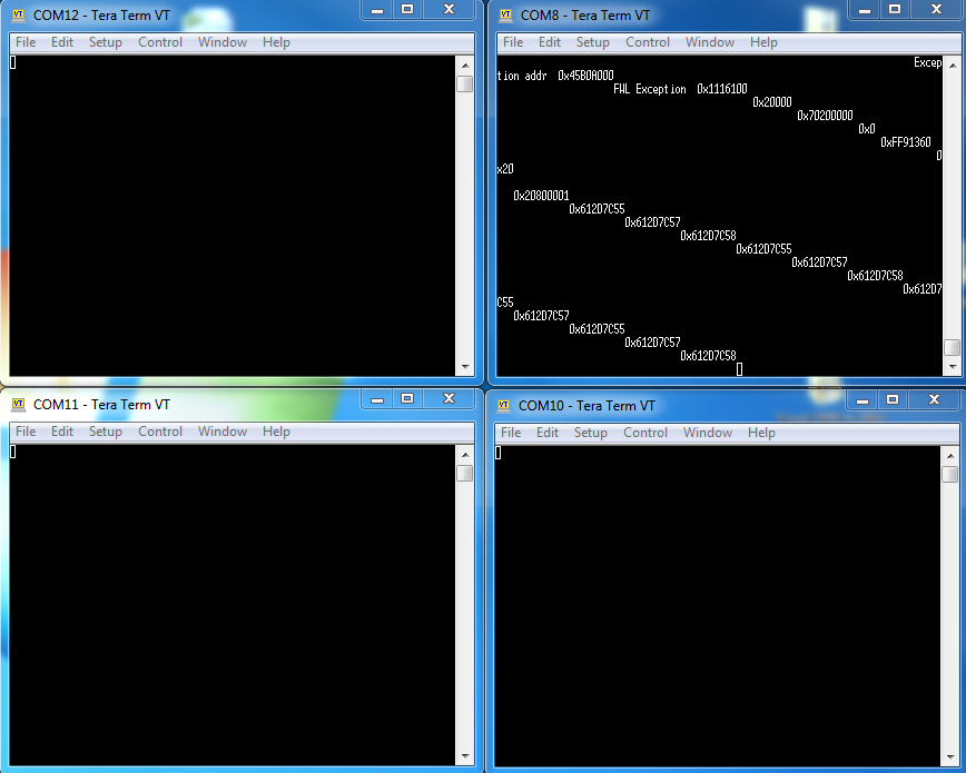

  • Hi Bin,
    Thanks for you reply.

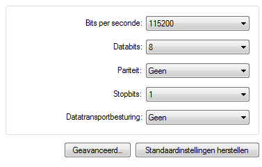

    So I have connected to each of the 4 com ports (again, have tried this), but I do not observe any of my UART_printf() calls to any of the 4 com ports. Not even hex or other dumps usually caused by baud rate issues. I do however observe the debug information from within CCS via the debugger and the printf() calls successfully.
    My UART is configured with default parameters (115200 baud, 0 parity 1 stop) by using the UART STDIO API and Board_init() calls. I do believe this is done correctly, as this is done like all the examples. I also do observe UART_printf calls successfully from the MCU_UART test header when using a max3232 level translator with an RS232 cable to my PC (This is not observed when a cable is plugged into the UART micro USB port (J42) though, I guess this has to do with Selection Logic when a cable is plugged in).
    So I am struggling to understand how I cannot get successful data transmission via the J42 as the software configuration appears to be successful as it is obverved from the test header?
    Johnny

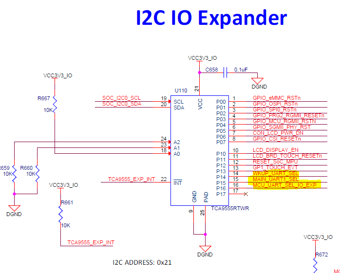

  • Hi Johnny,
    Now I see the problems you have are more about UART programming in RTOS SDK, I would have to route your questions to our RTOS folks, (I am a Linux guy, and initially noticed you connected to a wrong UART port in Tera Term, so replied, but now all your questions are out of my expertise...), further response will be posted here.
    I do want to point out that if you check the EVM schematics, there is a 2:1 MUX (U65) on MCU_UART RX taking data either from the FTDI UART RX, or the MCU_UART header RX. So the MUX Select pin (MCU_UART_SEL signal) has to be programmed to either high or low to select one of the RX input, or MCU_UART won't be able to receive data from any of the two inputs.
  • Hi Bin,
    Thanks for your response. I look forward to hearing from the RTOS team as soon as possible.
    I previously was not able to connect to the UARTs due to incorrect baud rate settings on Windows itself. However that is fixed, now I just still need successful connection to MAIN_UART1 and MCU_UART0 via the FTDI usb port .
    I have previously noted the MUX select pin (MCU_UART_SEL signal), however I cannot find any information on how to configure and program this pin. Could you provide some info regarding how to program this pin?
  • Hi Johnny,
    Our RTOS expert is busy on another task at the moment, he will work on your case soon.
    Regarding the MCU_UART_SEL signal, it is the output pin16 of the I2C IO Expander (U110, TCA9555RTWR) on the EVM. I am not sure if RTOS already has a driver for TCA9555, but you would have to program it to drive this GPIO pin high or low to select the MCU_UART RX.
  • Hi Johnny,
    As mentioned by Bin, I think there is problem with the I2C IO Expander settings.
    From the AM654x IDK User's Guide (spruim6.pdf):
    From the AM654x IDK schematic:
    Following the highlighted signals in the schematic, it can be seen:
    • WKUP_UART_SEL is an input to the 2x1 mux U83. The level on this signal determines whether WKUP_UART0 Rx & CTS is routed to the WKUP UART header J11, or FT4232HL U73.
    • MAIN_UART1_SEL is an input to 8x4 mux/de-mux U26. The level on this signal determines whether MAIN_UART1 Tx, Rx, RTS & CTS are routed to the application header J16, or FT4232HL U73.
    • MCU_UART_SEL_IO_EXP is an input (indirectly) to the 2x1 mux U65. The level on this signal determines whether MCU_UART0 Rx & CTS are routed to the MCU UART header J30, or FT4232HL U73.
    Can you please try the following experiment and see if you're able to observe output on the MCU UART?

    There are APIs for configuring the I2C IO expander here: pdk_am65xx_1_0_5\packages\ti\board\src\evmKeystone3\board_i2c_io_exp.c
    Example usage of the APIs can be seen here: pdk_am65xx_1_0_5\packages\ti\board\diag\led_industrial\src\led_industrial_test.c
    I'm still experimenting with these APIs, but I think they should allow you to route the UART signals to the desired location on the EVM.
    Frank
  • Johnny,
    I rebuilt the UART test program for A53: gmake apps LIMIT_BOARDS=am65xx_evm LIMIT_CORES=mpu1_0 BUILD_PROFILE="debug"
    I checked I'm able to see UART output for MAIN UART 0. In this case, I see output on COM5, and none on COM6 for the MCU UART.
    Next I tried a quick experiment where I changed this code in main_test_uart.c:UART_getTestInstNum():
        *instNum = BOARD_UART1_INSTANCE;//UART_INSTANCE;
    Unfortunately I don't see any MAIN UART1 output. I see power and clocks have been configured for MAIN UART 1. Hence I suspect the I2C IO Expander settings are incorrect, the pin mux settings are wrong, or both. I'll dig into this further and keep you posted on what I find.
    Frank

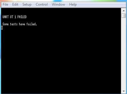

  • Hi Frank,
    Thanks so much for your detailed explanation, it is much appreciated. Even with your step by step explanation, I still have no success on observing MCU UART output via the FT4232HL. This is I do not understand. Please see my steps
    • I build the UART example test application.
    • I setup up Tera Term (115200 baud, 8 data, 1 stop, no parity) and connect to all 4 COM ports associated with the FT4232HL (Here it is COM 8,10,11,12)

    • I am booting in "No Boot' Mode the whole time, in other words, all switches (SW4 and SW3) are in the off position.
    • I have the exact same output as you in the CIO window, thus I have the exact same DMSC firmware version.
    With regards to the UART boot setting, I have booted with the Bootmode switches as mentioned. I still receive no MCU UART via the FT4323H. However I have 5 TeraTerm COM ports open at the moment, 1 that connects to MCU_UART test header via the RS232 port on my PC, and the other 4 is the FT4323H COM ports. When I remove the FT4323H USB cable while in UART boot mode, I iimmediately start observing the repeated output C character on the MCU_UART test header. The MCU_UART thus operates successfully, but clearly somewhere something in my configurations with the FT4323H and the MCU_UART there is something wrong. I guess this has to have to do with differnet Sitara and Shared Device support, or the incorrect automatic installation of the FTDI drivers? I think the latter is unlikely though, as I do observe successful output on the other COM ports (MAIN_UART0 and WKUP_UART)
    I have tried different USB ports on my PC, and moving it to different COM ports in Windows Device Manager as well, without success.
    I look forward to hearing from you on any advice from here, however in the meantime I will try to install other FTDI driver versions, as well as try to locate and install the device support packages that you have.

    Looking at the IDK schematic, I notice the MCU UART Tx signal is simultaneously routed to both FTDI and the MCU UART Test Header J30, and I don't see any hardware which selects one of these these two signal destinations as active while deactivating the other destination.
    As an experiment, I tried the following:
    • set EVM in UART boot mode
    • connected a scope to J30, pin 5 (TXD) & USB UART over FTDI via J42 to PC
    • power cycled board
    • on PC, connected TeraTerm to USB UART for MCU UART
    In this case, I observe:
    • continuous 'C' on the TeraTerm output. Note the frequency of the 'C' is about 1 / sec., so kind of slow.
    • continuous '0 1 1 0 0 0 0 1 0 1' on the scope. ASCII 'C' is 0 1 0 0 0 0 1 1 0', so this is the correct UART Tx for 'C' with MSB first (w/ Start bit, no Parity, and 1 Stop bit).
    If I disconnect the FTDI cable, the TeraTerm console stops working, so I need to reconnect TeraTerm. The output on J30 is not stopped by disconnecting the cable.
    I haven't tried this yet, but it would be interesting to see if we could connect a scope to FT4232_UART0_TX_3V3.
    I understand you observe output on MAIN_UART0 and WKUP_UART, but I think the current evidence we have points to the PC FTDI drivers.

    I uninstalled/reinstalled the drivers on all COM ports (used the method described on FTDI installation guides). Issue still persists.
    I also then set up a Windows 10 Virtual Machine and installed Tera Term on it to simulate a different PC. I then connected the FTDI USB uart to the virtual machine and tried to observe MCU UART output from there (maybe there is an error in my local PC windows COM port configuration such that Windows gets very confused).
    However, the output observed on the Virtual Machine is still the same with UART test app:
    - WKUP UART is observed when uploading/starting the debugger etc.
    - MAIN UART0 is observed and the UART test_app operates successfully and passes all tests via FT4232H. (uploading .xa53f binary on A53_0 core)
    - MCU UART observes nothing via FT4232H. (.xer5f binary on R5 core) Only when removing the USB cable, the first test is printed as "failed" to the MCU_UART test header:
    The same goes for UART bootmode:
    - No output is observed via the FT4232H (on any of the 4 COM ports), only when the USB cable is removed, the "C" character gets printed to the 5th COM port, which is the MCU_UART test header.
    I even tried to stupid things like swapping the COM ports around to match the order as mentioned in 10.3.1.1.3 UART connection. No success still.
    What FTDI driver version do you have installed, and on what Windows version?
    I also cannot see any other hardware configuration issues that might affect this. MCU_BOOTMODE switches maybe (SW4)? Here ALL my switches are in the OFF position, including ALL on SW2, SW3 and SW4. I am seriously stuck with regards to this and it is starting to get to me.
    I do hope we can sort this out as soon as possible.

  • Hi Johnny,
    I'm using Windows 10 Pro.
    I recently received a new Windows PC, and I never explicitly installed the FTDI drivers. This is what I see on my PC:
    According to the IDK UG (spruim6.pdf), the FTDI drivers can be obtained from here: https://www.ftdichip.com/Products/ICs/FT4232H.htm
    A few things to try:
    • Have you tried another physical PC?
    • Have you tried another EVM? Maybe something is wrong with U12 on your EVM.
    • Can you inspect FT4232_MCU_UART1_RX_3V3 in UART Boot mode? This would show whether the MCU UART Tx is working from the SoC. I haven't checked whether this signal is easily accessible anywhere on the EVM.

  • Hi Frank,
    That is the driver that Windows installed automatically through Windows update as well. When installing the drivers provided on the FTDI website, it appears to be a different version, however the same result. Observing WKUP and MAIN UART1, but not MCU UART. The port settings for each COM port (within device manager) is also selected to be 115200 baud, 8 data, 1 stop, no parity.
    I tried a different PC. Same results.
    Unfortunately, this is the only EVM I have. It is quite new as well, I think only 2 weeks old.
    The FT4232_MCU_UART1_RX_3V3 is not at all easily accessible, so I am not to sure as to how I will have to go about inspecting this signal. This signal according to me is only connected on U12 itself (which is extremely small) and the FT4232H chip (where it is also small and difficult to access).
    I agree that from the evidence we have, the problem should lie between the U12 and the PC FTDI driver. However having installed different FTDI drivers, and having tried testing it on different PC's, there is still no success on observing MCU_UART in UART boot mode.
    Johnny

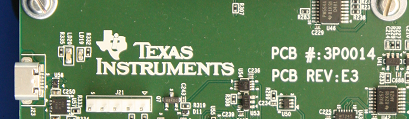

    My version of the board is E3.

    Yes, return is in process. In the meantime I have managed to program MCU_UART_SEL pin so that the Rx can be routed via the test header, so at least we can test some functionality.
    With this I will be marking this issue as resolved. Thanks for all your assistance!
