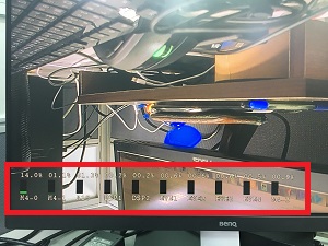

I would like to show the CPU loading information on screen, which is as follow.
How can I do that? Is there a document for reference?

Hi Gary,
there is no particular document for this, but you can check the implementation of GrpxSrcLink_drawCpuLoad() function in vision_sdk/apps/src/rtos/modules/grpxSrc/grpxSrcLink_cpu_load.c.

Hi Yordan,
Thank you for your reply.
Are there any examples showing how to use this function?
There are no usecase using this function. So I have no idea how to use it.
Can you provide me in more detail?
I tried to add GrpxSrcLink_drawCpuLoad() into OD usecase.
However, an error was occurred when compiling.
It said chains_tidlODAppObj is incompatible with GrpxSrcLink_Obj.
And I observed that the usecase "1CH VIP capture + Display" can show cpu load without using GrpxSrcLink_drawCpuLoad().
Can you advise me where should I add the function?
