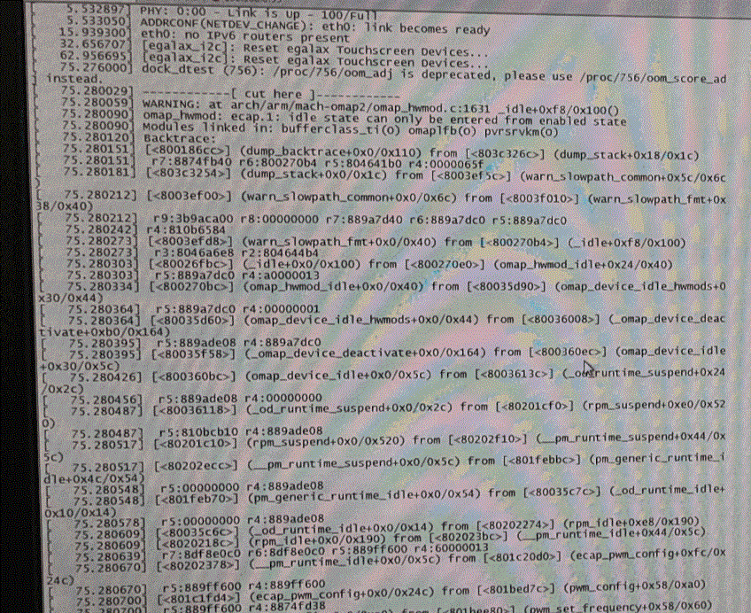

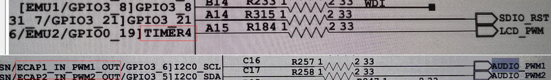

AM3352: PWM issue
Part Number: AM3352
SDK6, I know it is pretty old.
In customer use case, when use Timer 4 PWM mode and PWM 1, PWM2 together, will result in abnormal as below.
If only use Timer 4 PWM or PWM1/2, it is OK.
Please help have a look.  anymore information needed, please let me know.
