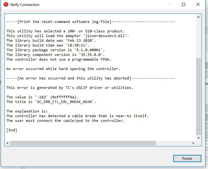

We made board with AM5749. USB debug schematic was taken from am5749 IDK design.
This is bare board, there are no boot monitor and u-boot inside. SBL also all with FF
Currently we unable to connect to am5749 via USB jtag using ccs\uniflash\sdk scripts, oscilloscope detects signal from CPU to ft2232h, but sowtware unable to detect am5749
Just look at screenshots:
What proper sequence to perform base initialization?
What proper firmware we need to flash into ft2232h?

    If you haven't done so, please use the FTDI template in the section "Template Collection" of the XDS100 page at:
    http://software-dl.ti.com/ccs/esd/documents/xdsdebugprobes/emu_xds100.html
    If programming the FTDI device does not work, it would be interesting to compare the schematics with the reference design shown at section "Target Connection Design" of the XDS Target Connection Guide page at:
    https://software-dl.ti.com/ccs/esd/documents/xdsdebugprobes/emu_xds_target_connection_guide.html
    Additional details about the connection error can be found at the Debugging JTAG page below (just search for the error number).
    https://software-dl.ti.com/ccs/esd/documents/ccs_debugging_jtag_connectivity_issues.html

    We succesfully resolved first step (flashing ftdi chip to enable onboard xds100 debug via usb) and now am5749 is fully visible in CCS  debug session.
    Second step is programming QSPI ROM. We need SBL firmware for IDK5749 board. Where we can find this file?
    Also we unable to connect uniflash. There are ccxml error.
    I`m attached made with ccs10 ccxml config that was succesfully tested in ccs10 via helloworld project.
    But this ccxml can`t be loaded via uniflash (v5.3.1). So provided by Dave instructions can`t be executed.
