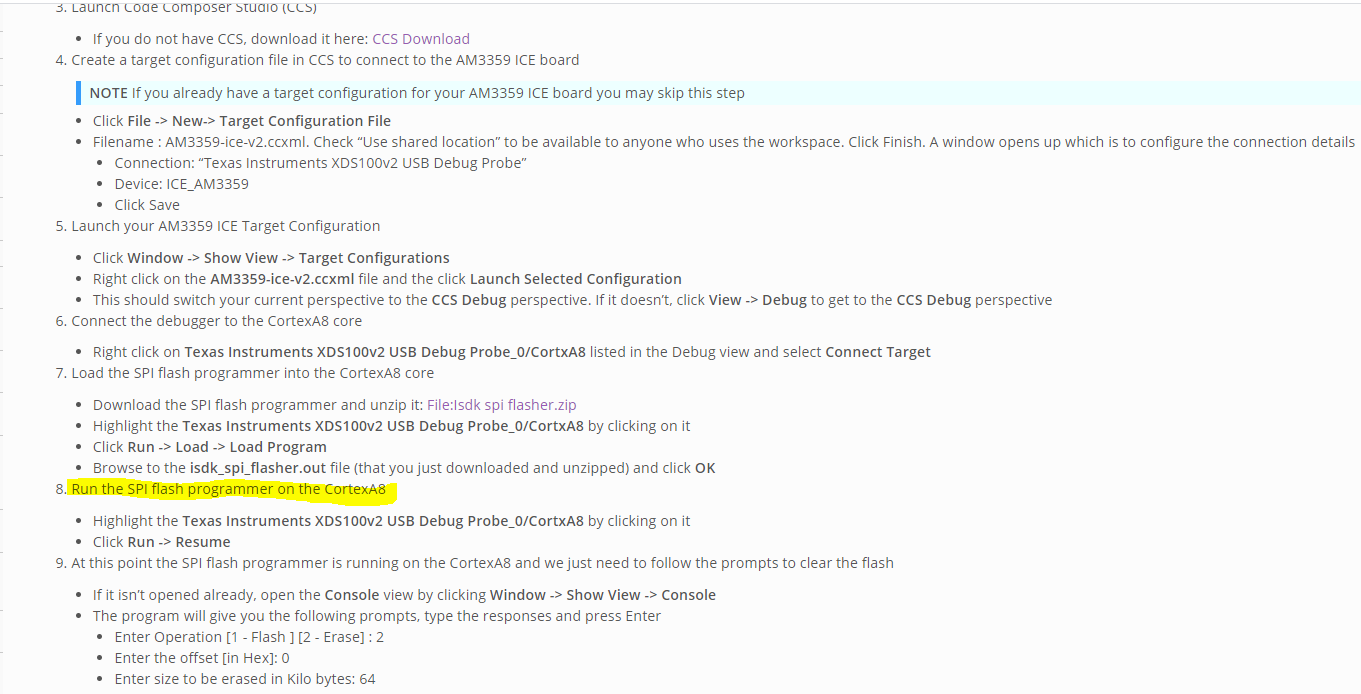

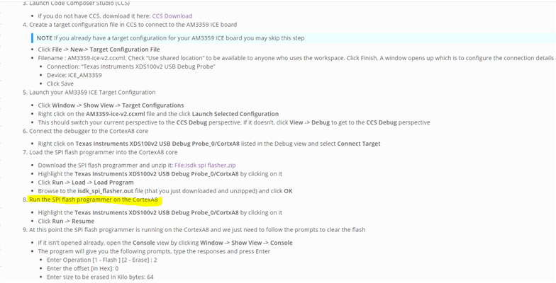

I just bought the new TMDSICE3359, and I want to boot with SD card. I saw that the SPI flash must be erased so that the boot process will fall back to SD card boot mode.
I followed the link below, but there was some problems.
http://software-dl.ti.com/processor-sdk-linux/esd/docs/latest/linux/How_to_Guides/Host/AM335x_ICEv2_flash_erase.html
After I run the SPI flash programmer on the CortexA8(the step I highlight), it is unable to read the correct device ID.
I wanna know what reasons cause this situation, and how can I fix it.
