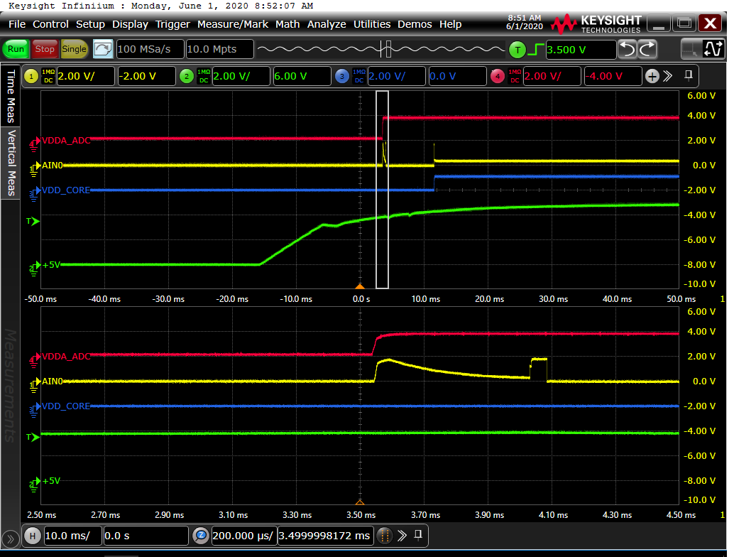

The following figures show the waveform at power-up.
The voltage is applied to AIN0 when VDDA_ADC power supply is turned on and VDD_CORE is not turned on. Could this be due to errata?
In addition, when VDD_CORE power is supplied, the voltage is applied for a short period of time. What is the reason for this?

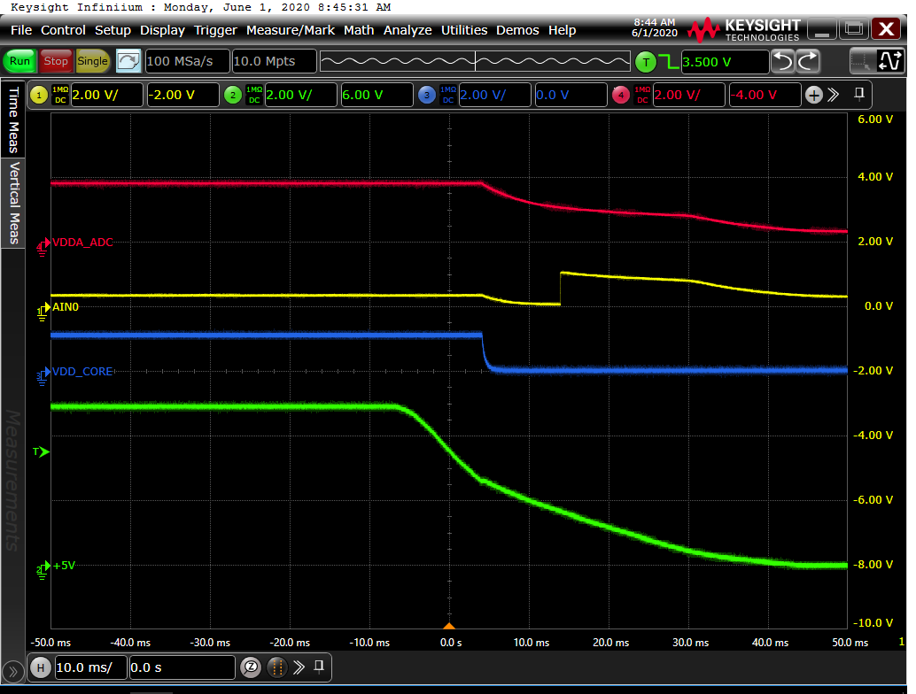

Also, The following figure shows the waveform at power down.
The voltage of VDDA_ADC appears at AIN0 about 10ms after VDDA_CORE falls, what is the reason for this?
Please tell me the reason for these behaviors and whether this is the assumed behavior.
H.U
  • The observed condition and cause is described in the advisory, where the state of ADC input pins are not defined until all device power pins are valid after power-up. A similar thing can occur when power is turned off as the supplies ramp-down.
    Power supply decay after power has been turned off may take longer than power supplies ramp-up when power is turned on.  So these unexpected conditions may last longer as the supplies slowly ramp-down. The PWRONRSTn pin should be held low while the supplies ramp up and down to minimize these conditions.
