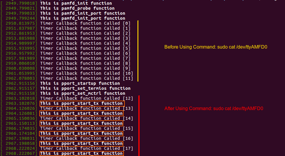

Testing the code on my PC (ubuntu 16.04 with kernel 4.15.0-106-generic), I don't get the correct output.
What I expect: is that if I run "$sudo cat /dev/ttyAMFD0", I should see the "t" character every second added to receive FIFO by timer, i.e. printing "t" every second on terminal .... But that is not the case ...
What happens: is that before running "$sudo cat /dev/ttyAMFD0", the timer just printk the statement in it, and after I run "$sudo cat /dev/ttyAMFD0" It calls start_tx without printing anything on terminal ... as I tested, start_tx is called because of calling tty_flip_buffer_push in code after inserting the character
I tried many things but none of them works... What could be the problem?
