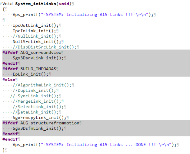

Hello all,
I am working on TDA2px EVM board and using Vision SDK 3.07. My usecase is running on hlos side, and I am in trying to optimize the same with which I need yourassistance. Please see the relevant log (log.txt) that I have attached. I would like to clarify the following things:
1. [HOST] [HOST ] 2.796773 s: While in main (OSA_waitMsecs 500ms)
In the above line, is this much wait time is absolutely necessary? Is there any way that I can reduce it without having any adverse effect on other parts?
2. Could you provide some pointers where the optimization can be done?
3. There are some time-lapses for which the reasons are obscure. Could you explain the reason for the same?
3.1 [HOST] [DSP1 ] 1.853931 s: SYSTEM: System DSP Init Done !!!
[HOST] [DSP1 ] 2.236808 s: SYSTEM: CACHE: L1P = 32 KB, L1D = 32 KB, L2 = 32 KB ... after boot !!!
4. Usecase creation time is also 1.7 Sec which is also huge. From 2.817910 to 4.503141. Any suggestion to reduce this time?
I will be waiting for your reply. Thank you,
Salman Nadaf

 [HOST] [HOST  ]      1.936039 s: OSA_getCurGlobalTimeInMsec is: 1936
 [HOST] [HOST  ]      1.936222 s:  SYSTEM: System A15 Init in progress !!!
 [HOST] [HOST  ]      2.237387 s:  SYSTEM: IPC: Init in progress !!!

 [HOST] [HOST  ]      2.237814 s:  SYSTEM: Initializing A15 Links !!!

 [HOST] [HOST  ]      2.240743 s:  SYSTEM: Initializing A15 Links ... DONE !!!
 [HOST] [HOST  ]      2.266790 s:  OSA: Adjusting global time, timeH by 0 units!!!
 [HOST] [HOST  ]      2.266790 s:  SYSTEM: System A15 Init Done !!!
    • >>>>> In A15 Linux, only "NullSource", "IPCout", "IPCin" & "SgxFrmcpy" links are used. So you can comment un-used links initialization in the HLOS as below
    file name:
    • Comment the below two links initialization from the main function in HLOS, these links are not used in your chain.
    • Do the same procedure for other used remote core( in your use-case DSP1 & IPU1_0 are used)
