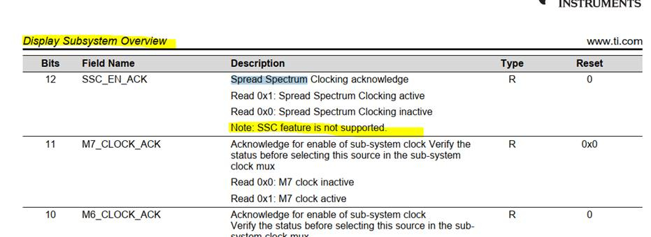

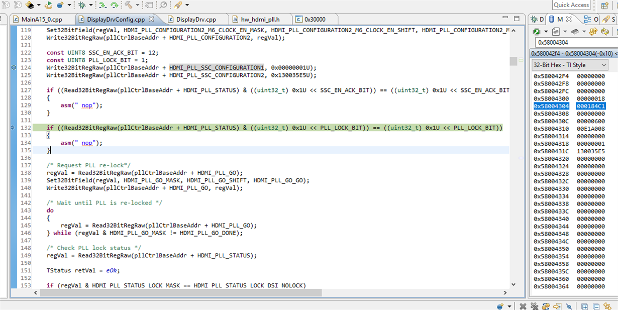

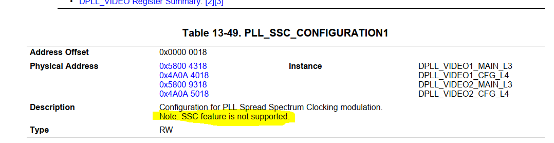

Since we are facing some issues in EMC in the RGB clock freq range, I was wondering if spread spectrum feature is available on Vout1_clk output. I've been checking the TRM (SPRUIF0C–May 2017–Revised February 2020) to figure it out. It seems there is an Spread spectrum feature available but it's not supported for this output! Could you please support me by answering following questions?
- Is the Spread Spectrum supported on Vout1_clk output?
- If yes, How we can enable the spread spectrum feature?
