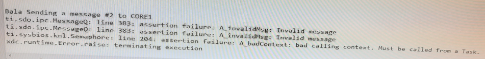

When I run the code my program aborted and a message printed in the console as below:
Why did this problem happen? how can I solve it?

    The MessageQ source is located at ~\ipc_3_50_04_07\packages\ti\sdo\ipc\MessageQ.c. The "A_invalidMsg" error indicates the msg is NULL.

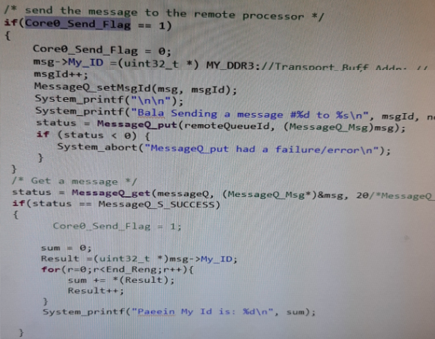

    Next, I decided to control sending data from Core0 by a flag that set in my Process task that I encountered the error.
    According to the " bad calling context, Must be called from a task", I integrated the IPC task into the process task, so the error " bad calling context, Must be called from a task" never happened.
    But when I set "Core0_Send_Flag" in a function the error of "Invalid message" appears again.
    The snapshot of my code on Core0 is as below:
    When "Core0_Send_Flag" set in the receiver part ( commented in the get message part) the program works correct but when "Core0_Send_Flag"
    set in a function at process task, the program aborted!!!
    Please guide me to solve the problem, Why the msg is null when I set "Core0_Send_Flag" in a function?
