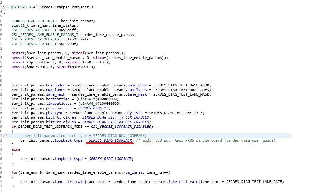

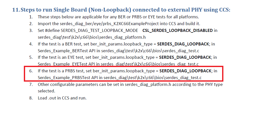

1) My question is about the 2nd modification:
The way item 6 is written seems to me not that clear.
Inside the "serdes_diag_test.c"  file I only found the "ber_init_params.loopback_type" once, and it is inside an "if" operation.
I did the following modification (see red underline)and want to know if this is what is expected from the user_guide :
(This forces "ber_init_params.loopback_type" to SERDES_DIAG_LOOPBACK whatever the SERDES_DIAG_TEST_LOOPBACK_MODE is)
2) another subsidiary question is to know to force TX side of the 66ak2h14 to also generate pure PRBS23 pattern. (even if no loopback exists outside)

    From the user guide, you need two changes for this:
    1. Set #define SERDES_DIAG_TEST_LOOPBACK_MODE CSL_SERDES_LOOPBACK_DISABLED in serdes_diag\test\k2x\c66\bios\serdes_diag_platform.h========> did you do this?
    2. If the test is a PRBS test, set ber_init_params.loopback_type = SERDES_DIAG_LOOPBACK; in Serdes_Example_PRBSTest API in serdes_diag\test\k2x\c66\bios\serdes_diag_test.c ==========>I saw you did this
    For how to generate PRBS23 pattern,
        ber_init_params.prbs_pattern = SERDES_PRBS_23; ======> you already did this in the Serdes_Example_PRBSTest().
    Regards, Eric

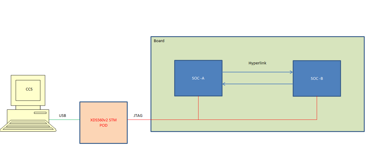

  • Hi Eric,
    When looking at my previous picture you can see that the 2 hyperlink partners are both 66ak2H14 located on the same board. There is no question of FPGA, nor other electronics.
    Both 66ak2h14 are controlled by the same emulator.
    The targeted datarate being 10Gb/s we would like to execute some BER tests. First test with SOC-A driving and SOC-B analyzing. Second test with SOC-B driving and SOC-A analyzing.
    To do so the hyperlink driver and hyperlink receiver must be synchronized in some way because the Rx side must be informed when the Tx side changes its CM,C1,C2 driving parameters, and when restart the new error counting sequence.
    I guess that this is performed by DSS in a board-1/board-2 setup when 2 different emulation pods are used, (one being connected to board-1 SOC, the other being connected to board-2 SOC) . Probably DSS sends start and resume commands to each emulator .....
    Therefore my question is to know if there is a way to configure DSS (I don't know exactly what DSS is)  , so that to mimic the same synchronization behaviour but with a single emulator pod controlling the 2 partners in my ONE board setup.
    Is this possible ?
    Bruno

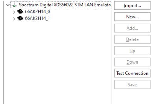

  • Hi Bruno,
    DSS can be used to run the BER test between the 2 SOCs connected to the same emulator. You can create a dual 66AK2H14 under the same emulator as below:
    Once you do that, you can modify the DSS script so that the names of the cores will point Device 1 to 66AK2H14_0 and Device 1 to 66AK2H14_1. Everything else should work as it is.
    Arun
  • Hi Aravind and Arun
    Thank you for your help.
    I updated the ccxml target-configuration file , as well as the .JS so that to call the new session name
    But since I understand there are some "writing specificity" depending upon the CCS version, I am not sure this is correct for my use case (CCSv910).

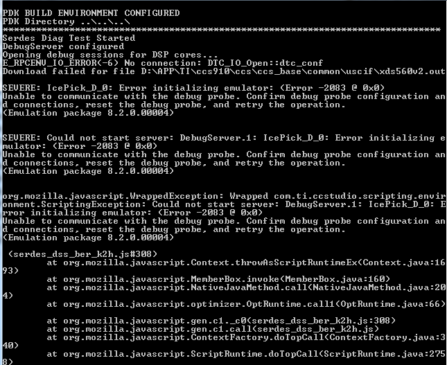

    Furthurmore launching the DSS script does not work as expected
    IT seems that dialog with the POD fails although the "Test Connection" performed under CCS environment is OK :

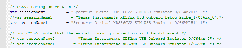

  • Hi Arun
    I took the following information from CCS and updated the DSS script with the corresponding naming
    I also closed CCS before launching the DSS script....and removed any remaining sd560v2u_server from the windows task manager.
    but unfortunately the results is the same
    Isn't it strange to get the "download failed for file .... xds560v2.out" message ? I have verified that the file do exist.

    The error you are getting is known as a host connection error. Basically the debugger is unable to communicate with the debug probe (your 560v2 in this case). The root case can vary greatly. Because the Test Connection command passes in CCS, the probe appears properly powered, configured, and detected by the host OS. My guess is that CCS still has a connection to the debug probe, even though you shut down CCS.
    You can try using the DTC CONF utility to see if the probe is being accessed by another program:
    https://software-dl.ti.com/ccs/esd/documents/xdsdebugprobes/emu_dtc_conf.html
    If all else fails, try rebooting your PC. I have had to resort to this occasionally when I could not resolve the issue otherwise.

  • Hi Aravind,
    We finally solved our problem :
    In the JS file we changed the line
    var session0 = server.openSession(sessionName0);
    into
    var session0 = server.openSession("*","C66xx_0");
    It is OK now.
