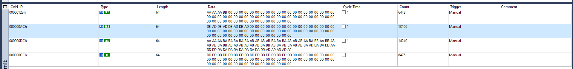

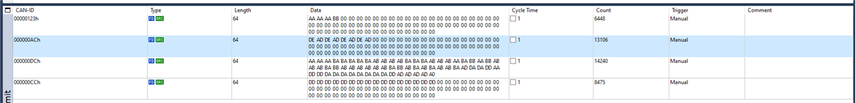

    Running and testing on the target:
    1. Connect the CAN emulator to the MCU MCAN0 or MCU MCAN1 (I am mentioning commands assuming your CAN emulator is connected to MCU MCAN0)
      1. The CAN emulator should be setup properly i.e. 1Mbps Nominal Bit rate and 5Mbps Data bit rate.
    2. Put the SD card prepared in previous step and boot the board.
    3. On the target, once booted to file system – run the below commands:
      1. ip link set can0 type can bitrate 1000000 dbitrate 5000000 fd on
      2. ip link set can0 up
      3. candump can0
    4. With candump can0 command running on the target, send messages with any ID to the TDA4. It should print the message on the console (as candump is running). See below
    CAN emulatore:
    Target:
    There are more details on the same on e2e FAQ - https://e2e.ti.com/support/processors/f/791/t/922168
    I believe this should help you with the HW checkout for MCU MCAN0 and MCU MCAN1. You can do the same for MCAN0 and MCAN2 (see the FAQ, that has patches for the same). Let me know if you see issues.
