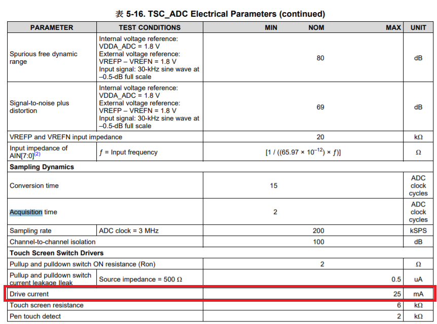

    I understood that the outflow current must be assumed to be infinite, However does the maximum value limit of the inflow current when this problem occurs should not exceed 25mA, as shown in  the DS below?
    UNA
  • Hi UNA,
    That parameter is saying that the Touch Screen Switch Drivers attached on the ADC are able to source up to 25mA into the device attached to the ADC, the expected device being a resistive touchscreen. So yes it should not exceed that value.
    Andrei
  • Hi Andrei,
    The Drive current is the maximum current that can be output from the AIN pin?
    So what is the maximum current that can be input to the AIN terminal?
    UNA
  • Hi UNA,
    There is no "safe" maximum input current that is defined for what can be input to the device AIN terminals. This is because under normal circumstances (in devices that are not susceptible to the errata), this should never be an issue. What the errata tries to explain, is that because of the internal muxing logic of the device, it is possible that the ADC pins are briefly taken to an unknown state during boot that can be anywhere from VSS to VDD, as such the source could be briefly "shorted" to ground for example.
    Normally we do not expect that this will cause any damage to our device, but, out of an abundance of caution, we advise on the use of a series resistor of 500 Ohms (as defined in the errata) mainly as a precaution for the source device from being overloaded during the bootup sequence.
    As for the max current that can be sourced by the AIN pin in that mode, because of the internal layout the pin is likely able to source much more current, but 25mA should be seen as the reference of what it can provide as defined by the datasheet.
