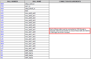

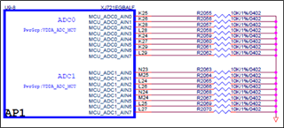

Should the ADC port not in use be pull-down using each resistor?
PCB is out of space. Is there a problem when connecting directly to GND or configuring PULL-DOWN with one resistor?

Yes - can use single resistor to pull down all ADC signals, recommended range of 1K to 10k-ohms.
