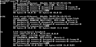

I do not see the eth1 interface when booting up with Linux on J7200/J721E devices using SD Card, there is no output on 3rd Main UART instance as well where Ethernet Firmware output usually comes.

5. If everything is ok then there will be an eth0, eth1 and eth2 interface

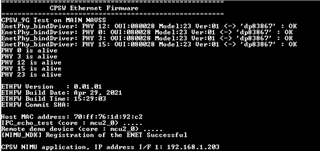

7. You can check Ethernet Firmware output using the command
"cat /sys/kernel/debug/remoteproc/remoteproc*/trace0"
It will show something like this
