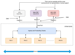

When a packet is received it goes through three stages, this is part of IEEE 802.3 Q protocol and not specific to the HW
If the 3 checks pass, then the packet is forwarded to the respective port (Host or Physical ports), else it gets dropped. See below:
For the CPSW IP, Host port can mean any of the cores in the SoC, either the Main R5F 2_0 which is running the Ethernet Firmware or any of the remote cores (A72, MCU R5F) which are running virtual clients. The destination is decided based on the Flow ID (Unique DMA ID) and CoreID (Unique ID for each core).
Without getting too much into concepts of Flow ID and Core ID it's enough to understand that they are required to tie any data flow to a particular core for the DMA and it is how packets are routed by CPSW within the SoC.
For this reason, whenever a rule is created in CPSW ALE to forward packets to Host Port it must also be tied to the relevant Core and Flow ID. This part is handled by the API's provided by ENET-LLD as we will later see with examples.
To know more about Flow ID's, please read the NAVSS Functional Description (Section 10.2.1.3) in TRM.
NOTE : Currently a packet can only be sent to one core as driver does not handle duplication. This is an issue for Multicast/Broadcast frames as multiple cores can subscribe to these frames, there is currently no workaround for this. So for example both Main R5F and A72 cannot receive broadcast frames but either one of them can.

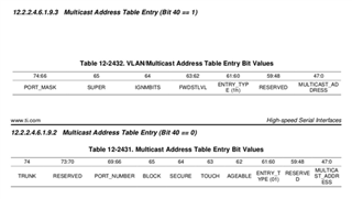

The entries for VLAN table are shown below:
The FDB entries are of four types (classified by ENTRY_TYPE[0:1] field)
See below:

There is currently no support to add an entry dynamically to the ALE from the remote cores (A72, MCU R5F) so one must add the entry in Ethernet Firmware and compile it before hand. This is done by adding a callback function to the MAC callback handler CpswProxyServer_registerMacHandlerCb() which adds a static configuration.
See flow-chart below:

printf("---------------------------------------------\n");
printf("PORT_MASK = %x\n", (word2 >> 2) & 0x1FF);
printf("SUPER = %u\n", (word2 >> 1) & 0x1);
printf("MCAST_FWD_STATE = %u\n", (word1 >> 30) & 0x3);
printf("ENTRY_TYPE = %u\n", (word1 >> 28) & 0x3);
printf("MULTICAST_ADDR = %x %x\n", (word1 >> 0) & 0xFFFF, word0);
void show_ale_entry_multicast_9g(uint32_t index, uint32_t word0, uint32_t word1, uint32_t word2)
printf(" Entry %u - Multicast\n", index);
printf("MCAST IGNORE BITS= %u\n", (word2 >> 0) & 0x1);
void show_ale_entry_vlan_multicast_2g(uint32_t index, uint32_t word0, uint32_t word1, uint32_t word2)
printf(" Entry %u - VLAN/Multicast\n", index);
printf("VLAN_ID = %u\n", (word1 >> 16) & 0xFFF);
void show_ale_entry_vlan_multicast_9g(uint32_t index, uint32_t word0, uint32_t word1, uint32_t word2)
void show_ale_entry_unicast_2g(uint32_t index, uint32_t word0, uint32_t word1, uint32_t word2)
printf(" Entry %u - Unicast\n", index);
printf("PORT_NUMBER = %u\n", (word2 >> 2) & 0x1FF);
printf("BLOCK = %u\n", (word2 >> 1) & 0x1);
printf("SECURE = %u\n", (word2 >> 0) & 0x1);
printf("UNICAST_TYPE = %u\n", (word1 >> 30) & 0x3);
printf("UNICAST_ADDR = %x %x\n", (word1 >> 0) & 0xFFFF, word0);
void show_ale_entry_unicast_9g(uint32_t index, uint32_t word0, uint32_t word1, uint32_t word2)
printf("TRUNK = %u\n", (word2 >> 10) & 0x1);
printf("PORT_NUMBER = %u\n", (word2 >> 2) & 0xF);
printf("TOUCH = %u\n", (word1 >> 31) & 0x1);
printf("AGEABLE = %u\n", (word1 >> 30) & 0x1);
void show_ale_entry_oui_unicast_2g(uint32_t index, uint32_t word0, uint32_t word1, uint32_t word2)
printf(" Entry %u - OUI Unicast\n", index);
printf("UNICAST_OUI = %x %x\n", (word1 >> 0) & 0xFFFF, (word0 >> 24) & 0xFF);
void show_ale_entry_oui_unicast_9g(uint32_t index, uint32_t word0, uint32_t word1, uint32_t word2)
void show_ale_entry_vlan_unicast_2g(uint32_t index, uint32_t word0, uint32_t word1, uint32_t word2)
printf(" Entry %u - VLAN/Unicast\n", index);
void show_ale_entry_vlan_unicast_9g(uint32_t index, uint32_t word0, uint32_t word1, uint32_t word2)
void show_ale_entry_vlan_2g(uint32_t index, uint32_t word0, uint32_t word1, uint32_t word2)
printf(" Entry %u - VLAN\n", index);
printf("FORCE_UNTAG_EG = %u\n", (word0 >> 24) & 0x1FF);
printf("REG_MCAST_FLOOD = %u\n", (word0 >> 16) & 0x1FF);
printf("UNREG_MCAST_FLOOD = %u\n", (word0 >> 8) & 0x1FF);
printf("VLAN_MEMBER_LIST = %u\n", (word0 >> 0) & 0x1FF);
void show_ale_entry_vlan_inner_9g(uint32_t index, uint32_t word0, uint32_t word1, uint32_t word2)
printf(" Entry %u - VLAN INNER \n", index);
printf("IVLAN_ID = %u\n", (word1 >> 16) & 0xFFF);
printf("NO FRAG = %u\n", (word1 >> 15) & 0x1);
printf("REG_MCAST_FLOOD = %u\n", (word1 >> 4) & 0x1FF);
printf("VLAN FWD Untagged Egress = %u\n",
((word1 >> 0U) << 0x100) + (word0 >> 24) & 0x1FF);
printf("LMT NEXT HDR = %u\n", (word0 >> 23) & 0x1);
printf("UNREG_MCAST_FLOOD = %u\n", (word0 >> 12) & 0x1FF);
void show_ale_entry_vlan_outer_9g(uint32_t index, uint32_t word0, uint32_t word1, uint32_t word2)
printf(" Entry %u - VLAN OUTER\n", index);
printf("OVLAN_ID = %u\n", (word1 >> 16) & 0xFFF);
void show_ale_entry_vlan_ethertype_9g(uint32_t index, uint32_t word0, uint32_t word1, uint32_t word2)
printf(" Entry %u - VLAN ETHERTYPE \n", index);
printf("ETHERTYPE = %u\n", (word0 >> 0) & 0xFFFF);
void show_ale_entry_vlan_ip4_9g(uint32_t index, uint32_t word0, uint32_t word1, uint32_t word2)
printf(" Entry %u - VLAN IPV4 \n", index);
printf("IGNORE BITS = %u\n", (word2 >> 1) & 0x1F);
printf("IPV4 ADDR = %u\n", word0);
void show_ale_entry_vlan_ip6_9g(uint32_t index, uint32_t word0, uint32_t word1, uint32_t word2)
printf(" Entry %u - VLAN IPV6 \n", index);
printf("Understanding Gap hence not printing :(");
void cpsw_print_ale_table_2g()
uint32_t word0, word1, word2;
uint32_t type;
int i;
printf("-------CPSW2G ALE TABLE----------------------\n");
for (i = 0; i < ALE_TABLE_DEPTH_2G; i++)
mmio_write_32(ALE_TBLCTL_2G, i);
word0 = mmio_read_32(ALE_TBLW0_2G);
word1 = mmio_read_32(ALE_TBLW1_2G);
word2 = mmio_read_32(ALE_TBLW2_2G);
if (0)
printf("WORD1 = %u\n", word0);
printf("WORD1 = %u\n", word1);
printf("WORD1 = %u\n", word2);
/* ENTRY_TYPE (bits 61:60) */
type = (word1 >> 28) & 0x3;
if (type == ALE_ENTRY_EMTPY) {
//printf(" Entry %u - Empty\n", i);
} else if (type == ALE_ENTRY_ADDR) {
if ((word1 >> 8) & 0x1) {
show_ale_entry_multicast_2g(i, word0, word1, word2);
// } else if ((word1 >> 30) & 0x3) {
// show_ale_entry_oui_unicast(i, word0, word1, word2);
} else {
show_ale_entry_unicast_2g(i, word0, word1, word2);
} else if (type == ALE_ENTRY_VLAN) {
show_ale_entry_vlan_2g(i, word0, word1, word2);
} else if (type == ALE_ENTRY_VLAN_ADDR) {
show_ale_entry_vlan_multicast_2g(i, word0, word1, word2);
} else {
show_ale_entry_vlan_unicast_2g(i, word0, word1, word2);
printf("Completed analysis of %u ALE entries\n", i);
void cpsw_print_ale_table_ng(numAleEntries)
uint32_t type;
uint32_t vlanEntryType;
int i;
printf("-------CPSWnG ALE TABLE----------------------\n");
for (i = 0; i < numAleEntries; i++)
mmio_write_32(ALE_TBLCTL_9G, i);
word0 = mmio_read_32(ALE_TBLW0_9G);
word1 = mmio_read_32(ALE_TBLW1_9G);
word2 = mmio_read_32(ALE_TBLW2_9G);
if (0)
printf("WORD0 = %x\n", word0);
printf("WORD1 = %x\n", word1);
printf("WORD2 = %x\n", word2);
show_ale_entry_multicast_9g(i, word0, word1, word2);
else if ( ((word1 >> 30) & 0x3) == 0x2 )
show_ale_entry_oui_unicast_9g(i, word0, word1, word2);
else
show_ale_entry_unicast_9g(i, word0, word1, word2);
vlanEntryType = ((word1 >> 30) & 0x3);
vlanEntryType |= ((word2 >> 0) & 0x1);
if ( 0x0 == vlanEntryType)
show_ale_entry_vlan_inner_9g(i, word0, word1, word2);
else if ( 0x2 == vlanEntryType)
show_ale_entry_vlan_outer_9g(i, word0, word1, word2);
else if ( 0x4 == vlanEntryType)
show_ale_entry_vlan_ethertype_9g(i, word0, word1, word2);
else if ( 0x6 == vlanEntryType )
show_ale_entry_vlan_ip4_9g(i, word0, word1, word2);
else if ((word1 >> 30) & 0x1)
show_ale_entry_vlan_ip6_9g(i, word0, word1, word2);
show_ale_entry_vlan_multicast_9g(i, word0, word1, word2);
else {
show_ale_entry_vlan_unicast_9g(i, word0, word1, word2);
void cpsw_print_ale_table_5g()
cpsw_print_ale_table_ng(ALE_TABLE_DEPTH_5G);
void cpsw_print_ale_table_9g()
cpsw_print_ale_table_ng(ALE_TABLE_DEPTH_9G);
void cpsw_ng_clear_stats(uint32_t numMacPorts)
uint32_t portnum, baseAddr, numStats;
for (portnum = 0; portnum <= numMacPorts; portnum++)
baseAddr = 0x0C03A000U + (portnum * 0x200);
printf("Clearing stats for port[%d]\n",portnum);
for (numStats = 0; numStats < 128U; numStats++)
cpsw_clear_stat(baseAddr + (numStats*0x4));
printf("--------CLEARED ALL STATS-------\n");
void cpsw_5g_clear_stats()
cpsw_ng_clear_stats(CPSW_5G_PORT_NUM);
void cpsw_9g_clear_stats()
cpsw_ng_clear_stats(CPSW_9G_PORT_NUM);
int main()
//cpsw_9g_statsprint_nonzero();
cpsw_print_ale_table_5g();
This file needs to be compiled on the device using GCC and executed. It has functions for various tasks, from print statistics to printing ALE entries.
