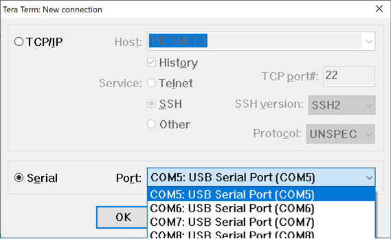

    • You will see total of four ports enumerated on the PC. These port numbers will be continuous in order (in this case, it is COM 5,6,7,8).

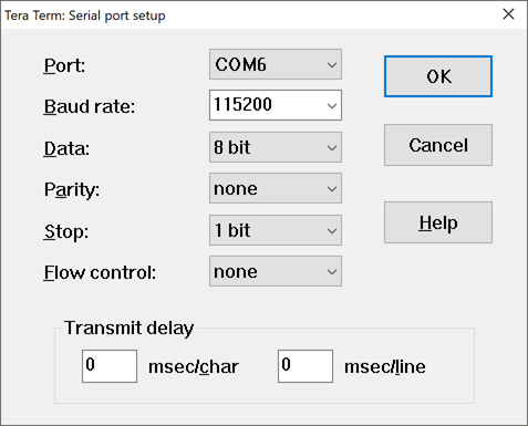

    • OPEN the first port number (MAIN domain) and the second port number (MCU domain) (in this case, COM 5&6 corresponds to MAIN and MCU respectively).
    • Now open setup -> serial_port menu and do the below settings for both the ports:
