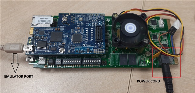

Connection diagram:

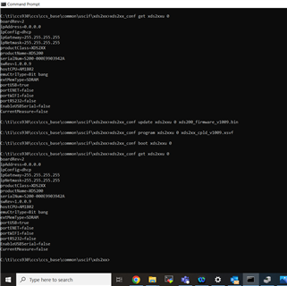

    b. Launch and Run the configuration file (.cxml )  just to make sure a XDS200-class debugger is connected.. and to know the firmware-revision installed on it.
C:\ti\ccs0930\ccs\ccs_base\common\uscif\xds2xx>xds2xx_conf get xds2xxu 0
    c. Run the commands in the exact order shown below:
C:\ti\ccs0930\ccs\ccs_base\common\uscif\xds2xx>xds2xx_conf update xds2xxu 0 xds200_firmware_v1009.bin
C:\ti\ccs0930\ccs\ccs_base\common\uscif\xds2xx>xds2xx_conf program xds2xxu 0 xds2xx_cpld_v1009.xsvf
C:\ti\ccs0930\ccs\ccs_base\common\uscif\xds2xx>xds2xx_conf boot xds2xxu 0

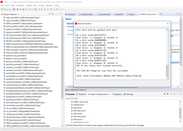

  d. Run the command in step 2 again to check that the correct firmware was loaded.
