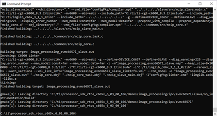

    PDK build
     1. Open command prompt.
     2. Go to the install directory of PDK
          >cd C:\ti\pdk_c665x_2_0_16\packages
    3. Run the pdksetupenv.bat - To set up the environmental variables.
          C:\ti\pdk_c665x_2_0_16\packages>pdksetupenv.bat
    4. Build the pdk using gmake
          C:\ti\pdk_c665x_2_0_16\packages>gmake clean -j4
          C:\ti\pdk_c665x_2_0_16\packages>gmake all -j4
    SDK build
     2. Go to the install directory of processor_sdk_rtos_c665x_6_03_00_106
         >cd C:\ti\processor_sdk_rtos_c665x_6_03_00_106
    3. Run the setupenv.bat - To set up the environmental variables.
          C:\ti\processor_sdk_rtos_c665x_6_03_00_106>setupenv.bat
    4. Build the sdk using gmake
          C:\ti\processor_sdk_rtos_c665x_6_03_00_106>gmake clean -j4
          C:\ti\processor_sdk_rtos_c665x_6_03_00_106>gmake all -j4
