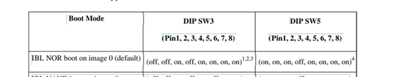

    Step 3 -  Booting IBL:
    1. Change the DIP switch settings into
    1. Open hyper terminal or putty and Connect the UART
    2. Observe the IBL booting with version either as 1.0.0.15 or 1.0.017

    Step 5 - Booting IBL + app binary
    2. Observe the IBL booting with version, 1.0.0.15 or 1.0.017
    3. Observe the IBL jumps to the UART app.
