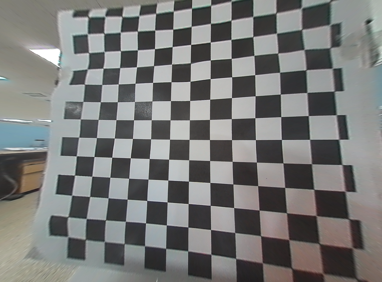

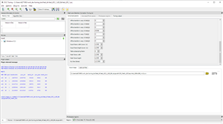

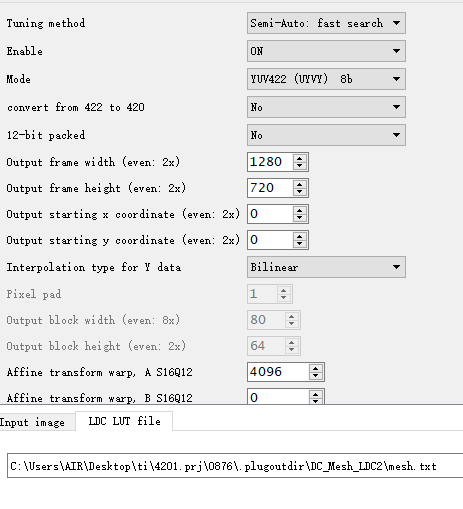

4. Load "mesh.txt" above along with the LDC input YUV image from the camera into DCC tuning tool to generate a LDC preview and the DCC xml file for LDC.
Tuning tool can take care of the block size and H/W padding details (please follow the LDC plugin guide from the help menu).
The blue text in below screenshot shows the top 5 best options for LDC output block size and padding along with the corresponding DDR read bandwidth per output image.
LDC input image with fisheye distortion:
https://e2e.ti.com/cfs-file/__key/communityserver-discussions-components-files/791/original-image_5F00_1280x944_5F00_uyvy.yuv
LDC output preview from DCC tuning tool:
DCC xml file and its included LUT in H/W format exported by DCC tuning tool.
