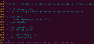

- The specific driver can have all of it’s OSAL calls replaced by the AUTOSAR environment equivalent. This would still use OSAL APIs in the the other libraries taken from the PDK. However, there can be OSAL APIs in a driver and the AUTOSAR environment equivalents would allow for simple replacement. The following example from the SDK 8.0 I2C PDK driver shows a location where an OSAL function could be replaced, I2C_osal.h:
- Here, HwiP_disable() would be replaced with the corresponding function which can disable interrupts for critical sections of code.
