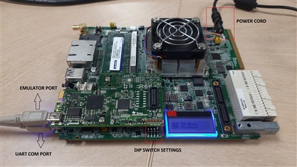

  • Connection details:
    The DIP switch settings should be in "Noboot Mode" - SW3- 0001
