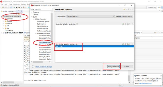

    While building Platform lib of PDK in Processor SDK 6.3, if received CSL errors, Please do the following steps:
    1. Right click and go to project properties
    2. Build options --> C6000 compiler --> advanced option--> Pre-defined symbols --> ( --define ) click Add symbol --> SOC_C6657
    3. Apply and close.
    4. Build again.
    Please watch the video for the same steps:
