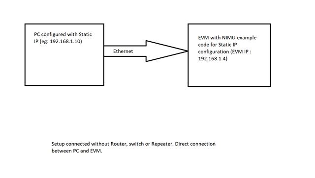

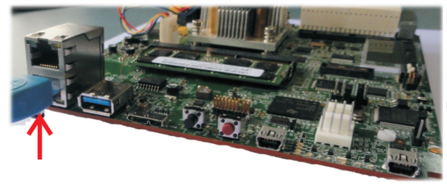

      7. Unlike C665x and C667x examples, Telnet and HTTP service were not included in the source code. So, TCP Ports 23 and 80 remain closed and only verification can be done using the Ping utility.
      8. Note: While connecting EVM with PC in static IP mode without a router (Kind of like Local LAN). The Ping between PC and EVM is not happening.
