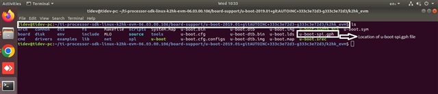

    4. Goto "{SDK_FOLDER}/board-support/u-boot-{VERSION}/" folder and below commands will remove the previous builds,
      make CROSS_COMPILE=arm-linux-gnueabihf- distclean
      rm -rf ./k2hk_evm
    5. For compilation and build, please give following commands
      make CROSS_COMPILE=arm-linux-gnueabihf- O=k2hk_evm k2hk_evm_defconfig
    6. After successful compilation, Inside "k2hk_evm" directory "u-boot-spi.gph" file will be present.
