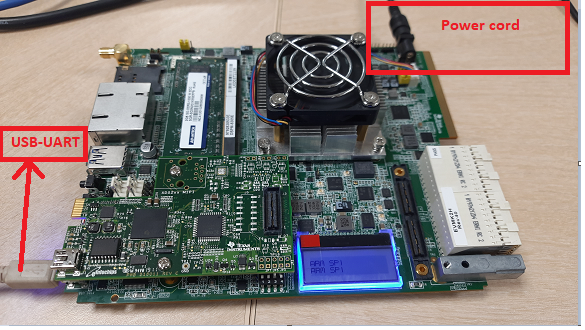

    Connection details:
    1. Connect through "Serial terminal" with following serial settings
      1. Baud rate : 115200
      2. Data bit    : 8
      3. Stop bit    : 1
      4. Parity       : None
      5. Flow control : None
    Connect Ethernet cable too.

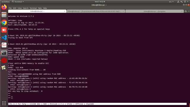

    And, now U-boot runs on the RAM and flash it to the NOR memory by giving the following commands sequentially in the mentioned order (Also give commands either DHCP or static IP, do not give both commands)
    //Load default environment variables
    # env default -f -a
    //If device(EVM) IP address is set through dhcp
    # setenv autoload no
    # dhcp
    //If device(EVM) IP address has to be set manually
    # setenv ipaddr 192.168.2.250
    # setenv gatewayip 192.168.2.1
    # setenv netmask 255.255.255.0
    //set tftp serer ip
    # setenv serverip 192.168.2.252
    //set name_uboot to file name "u-boot-spi.gph"
    # setenv name_uboot u-boot-spi.gph
    # saveenv							//make local variables into environment variables
    # ping ${serverip}
    # tftp ${loadaddr} ${serverip}:${name_uboot}
    # run burn_uboot_spi
    1. Here, TFTP server created using "Mobaxterm" software and U-boot moved from Linux PC to windows for ease.
