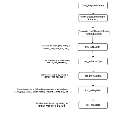

This document is intended to explain the interrupt registration process for R5F cores used in TI PDK
  • There are two steps for configuring the interrupts, interrupt routing and registration of interrupt with the core. TI PDK uses sci client calls to route the interrupts to the core and used OSAL layer to register the core interrupts and hook the required ISR with the interrupt. This document explains the registration process. This document explains how OSAL registration works for R5F with the explanation of register set involved.

    Flow of interrupt registration :
