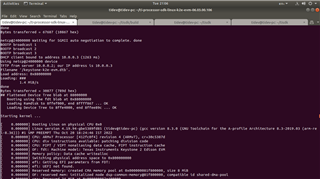

    7. Now the Screen appears like this

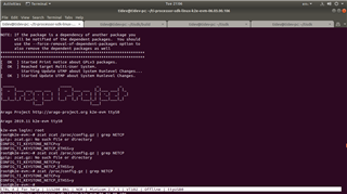

    10. Screenshots of UBI Image flashing steps are presented here.
    11. The EVM will reboot and boot into Linux OS.
