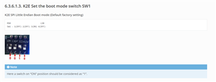

    3. Power up and Boot the K2H EVM in ARM SPI mode, For boot mode switch settings, This SDK documentation gives the larger picture of Boot mode switch settings.
    4. Check for the "BOOT COMPLETE" message on the LCD screen in EVM.

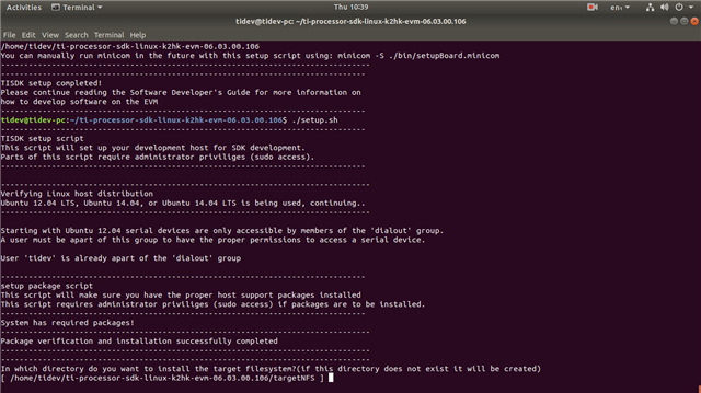

    6. In the host PC, Open the Bash Terminal and run "setup.sh" which is present in "/home/${USER}/ti-processor-sdk-linux-k2hk-evm-06.03.00.106"
    7. Kindly follow the video,
    8. The questions asked during the execution will be answered
      1. Give the path of "targetNFS" to install else, it will choose the default path. "[ {SDK Folder}/targetNFS ]".
      2. Now select the "TFTP" server's root directory.

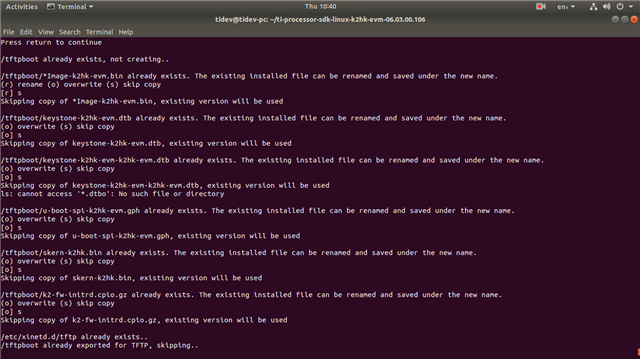

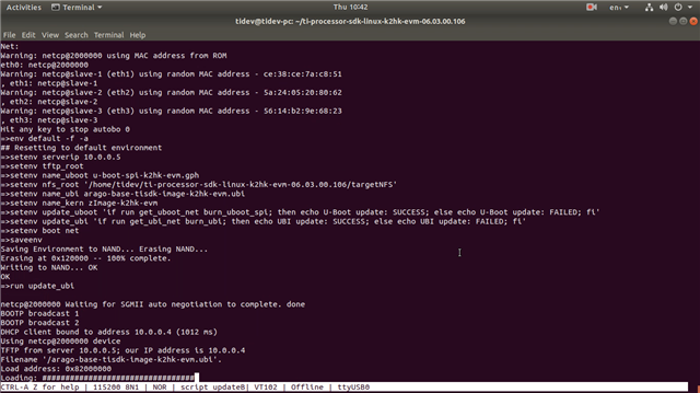

      3. Now, The setup will copy the following files into the TFTP server root directory (TFTP server root of the Host system)
        1. zImage-k2hk-evm.bin,
        2. keystone-k2hk-evm.dtb,
        3. uboot-spi-k2hk-evm.gph,
        4. skern-k2hk.bin and
      4. k2-fw-initrd.cpio.gz. All those files are located in the "{SDK Folder}/board-support/prebuilt-images" folder.

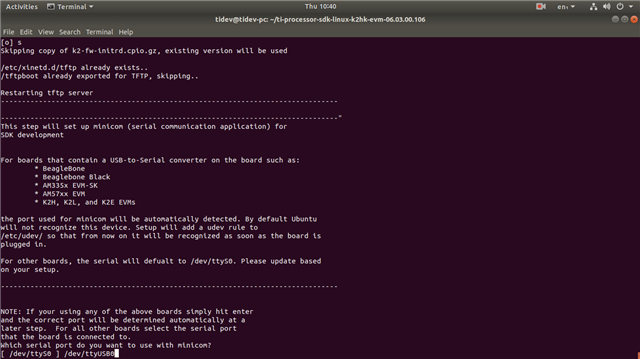

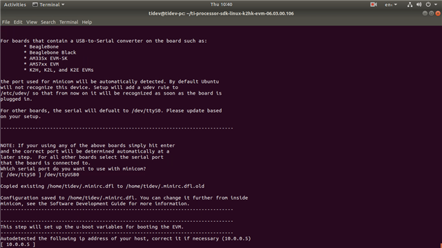

      5. Now, Input the serial port of the EVM "/dev/ttyUSB0" to configure Minicom configuration.
      6. Now it will show the system IP for the TFTP transaction.

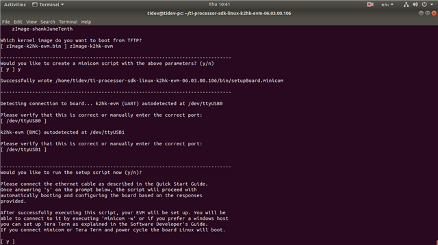

      7. Now select the UBI image, choose U-Boot, and the UBI file system needs to be installed.
      8. Select the "ZImage", "Secondary Boot", "UART Port", "BMC Port".
      9. It will open Minicom and update the image from U-Boot.

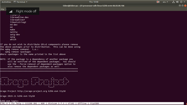

      10. On successful boot, it will show as below.
