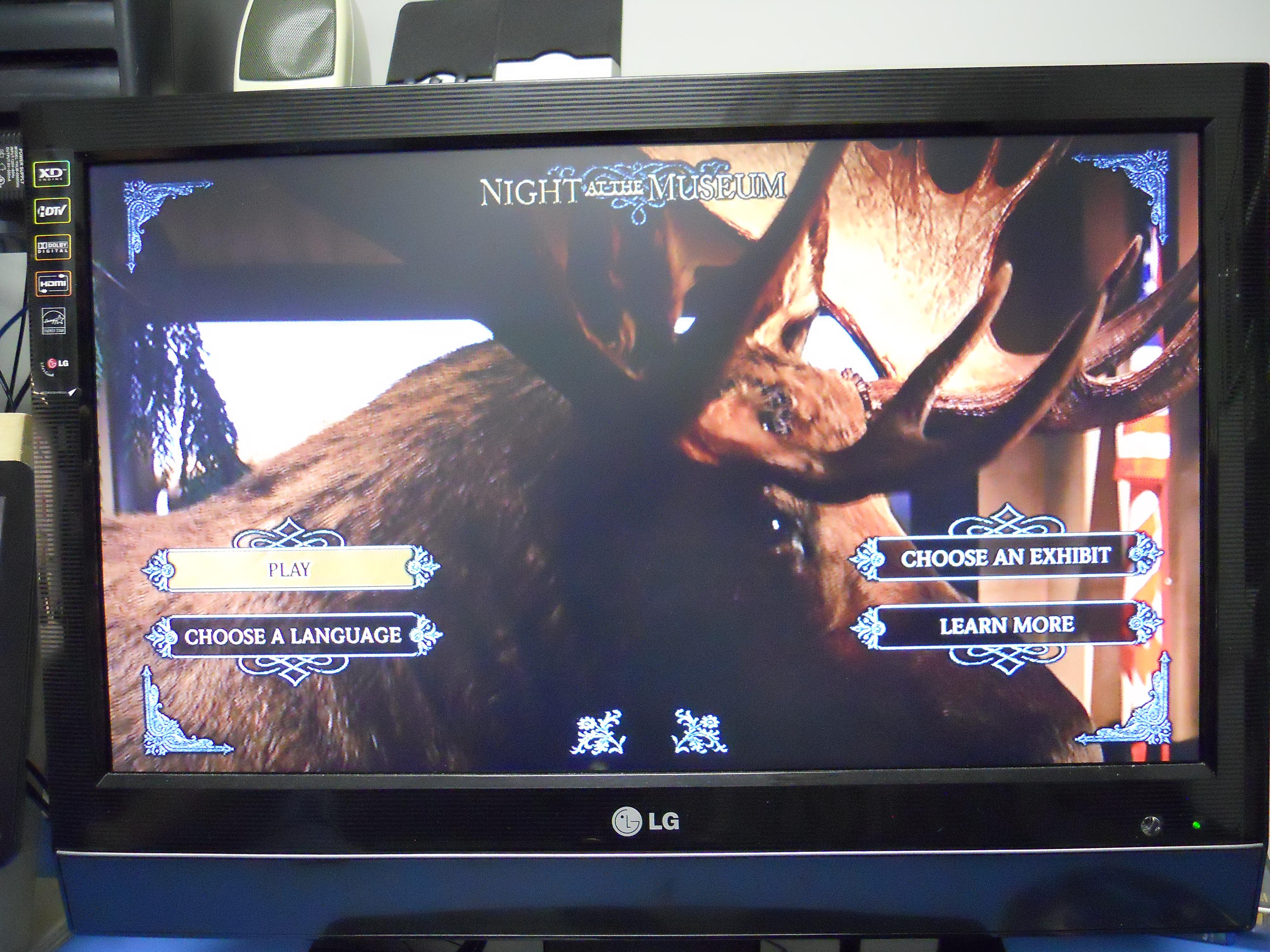

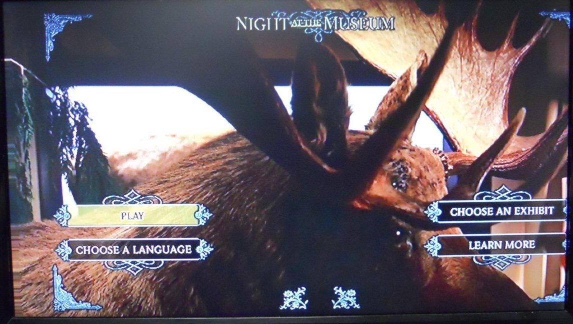

Specifically, the decoded video shows a vertical line of distortion at the extreme left side of the display and the video data itself is shifted to the right so that the extreme right part of the video frame is cut off. The vertical distorted line sometimes appears as if the pixels are “smeared” and the width of this line is probably around 30 or 40 pixels.
