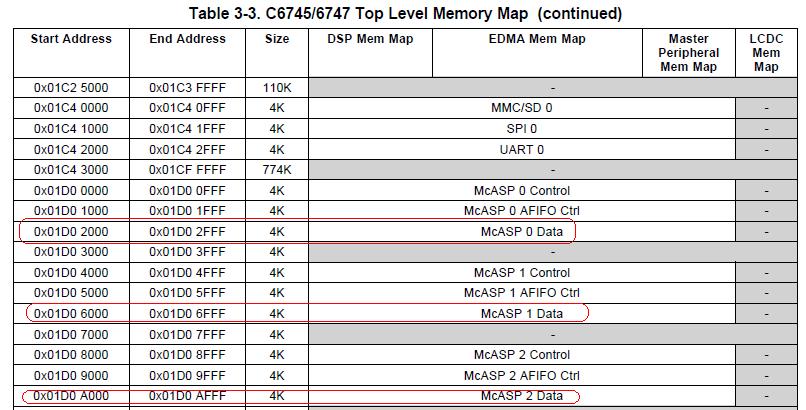

I need some help to solve the following two problems:
1. I can receive data from McAsp through peripherial port by CPU polling mode,  but I can't read anything through DMA port(RBUSEL=0), why?
2.I can't use EDMA to service McAsp, the configuration is as below:
EDMA3PaRAM2_OPT=0x00000201;   //1D-1D Transfer with A-syncronization
 EDMA3PaRAM2_SRC=0x01D01BA0;   //source address:MCASP1_RBUF1
 EDMA3PaRAM2_A_B_CNT=0x00400024;  //BCNT=40;ACNT=36
 EDMA3PaRAM2_DST=0x11800000;   //destination:DSP L2RAM
 EDMA3PaRAM2_SRC_DST_BIDX=0x00240000;
 EDMA3PaRAM2_LINK_BCNTRLD=0x0024FFFF;
 EDMA3PaRAM2_SRC_DST_CIDX=0x00000000;
 EDMA3PaRAM2_CCNT=0x00000003;  //CCNT=3
/*EDMA3PaRAM2 configuration complete*/
 EDMA3CC_EESR=0x00000004; //enable EDMA_EVENT_2(start EDMA)
could someone tell me why? I really need your help, thank you
  • I apologize for the unclear documentation.  I've submitted a request internally to clarify on this point.  When using RBUSEL=0 you need to use a different address to access the "DMA port".  The address is what we call "McASP 1 Data" in the Memory Map section of the data sheet.  I've attached a screenshot of what I'm talking about below.  Try using 0x01D06000 as your source address.

  • Do you use the same address for both transmit and receive?  I've been trying to get McASP/DMA working without driver overhead and have been running into similar problems as Daisy.
    Chris
  • Yes, that same address range can be used for receive or transmit.  The hardware is able to route data to/from the receiver or transmitter based on whether you're doing a read or write from that address.
