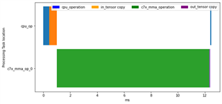

      • Additional information is printed as a dictionary of timestamps (in nanoseconds) representing different events in the inference process. This can be visualized (functions present in edgeai-tidl-tools repo and on Model Analyzer) like so:
        • Note that this figure is generated on Model Analyzer, but was modified to be more accurate. The in/out_tensor_copy happens on the CPU. This copy latency can be mitigated with shared buffers, but this requires the C++ API’s for the deep learning runtimes (OSRT and TIDL-RT)
