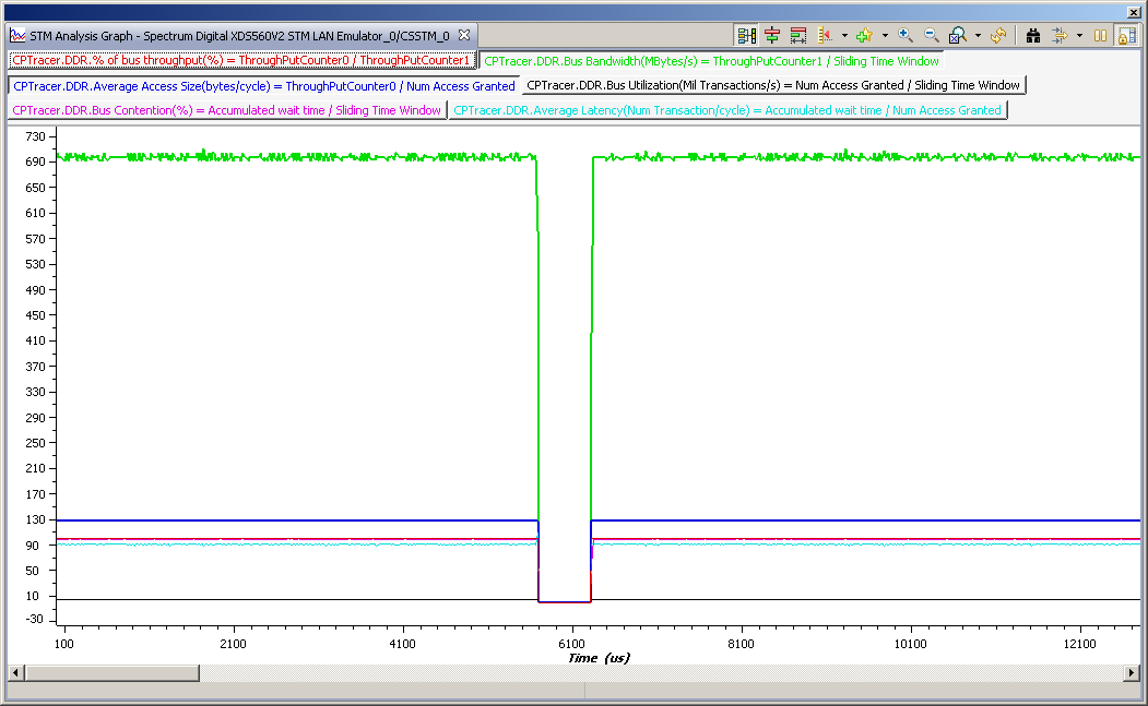

  • I did some tests with the XDS560v2 CP System Trace.
    Trace Settings:
    • Transaction Monitor: DDR3 (PCI write destination memory)
    • Function: Transaction Statistics
    • Bandwidth Type: Total Bandwidth Profile
    • Transaction Master: PCIe
    • Sample Window: 10000 (20us)
    Results:
    The most interesting signals are the bus bandwidth (green) and the access size (blue). There is a pause in data transmission for a few hundred us, which is normal.
    • MAX_PAYLD: 128 byte, Payload: 128 byte
    • MAX_PAYLD: 256 byte, Payload: 128 byte
    • MAX_PAYLD: 256 byte, Payload: 256 byte
    For 256 byte payload packets, the Average Access Size remains at 128 bytes (blue line). I'm not sure if the packets get divided by the DSPs PCIe unit.
    Maybe it's possible for someone to do a performance test with two Keystone devices connected to each other, like in sprabk5.pdf. The idea is to change the MAX_PAYLD register to 256 byte and to check if the throughput then decreases like in my case.
    Ralf
