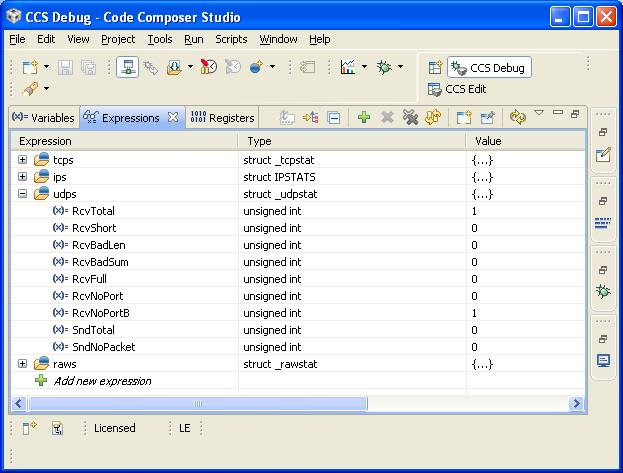

    So RECV MCAST number is getting bumped.  It is highly unlikely that RX and TX statistics counts would be swapped, as other TX and RX statistics look inline.
     Could you also check the NDK statistics.
    See snapshot below :
  • hi varada
     i have  checked udps values the count are not increasing for multicast reception.
    i run my code with a break point at ip.c file in function which receives IP packets but multicast packet are not reaching there.
    is the packets are getting filtered at IP layer ?
    Which function does the IP filtering?
    Is my multicast add is not getting register in IP layer?
    One more thing Igmp packet should be send periodically but IP_ADD_MEMBERSHIP send it only ones.

    i am testing TMDXEVM6678LE  kit and using  NDK_2_20_06_35 , pdk_C6678_1_0_0_20 ,mcsdk_2_00_08_20 version. can u tell what is worng in this.
    i am able to receive multicat and broadcast packets but not muticast.

    From your stats, it seems like the emac itself did not receive any MCAST packet. Are you sure you send multicast? The EMAC is the entry point of the device for ethernet packets. please make sure that you indeed sending the MCAST packets.
    Arun.
  • hi Arun
    Thanks for looking at my problem
     i am using a linux application for sending multicast packets. i verify the reception by receive this packets through another Linux application and i am using a L3 maneged switch  there also i can observe that multicast packets are forwarded to TMS6678 port..
    and i have print of EMAC register

       it seems that when i send packet form EVM  'RxMCastFrames' and 'RxGoodFrames ' count increase and when i receive then  'TxMCastFrames ' and 'TxGoodFrames' increases.
