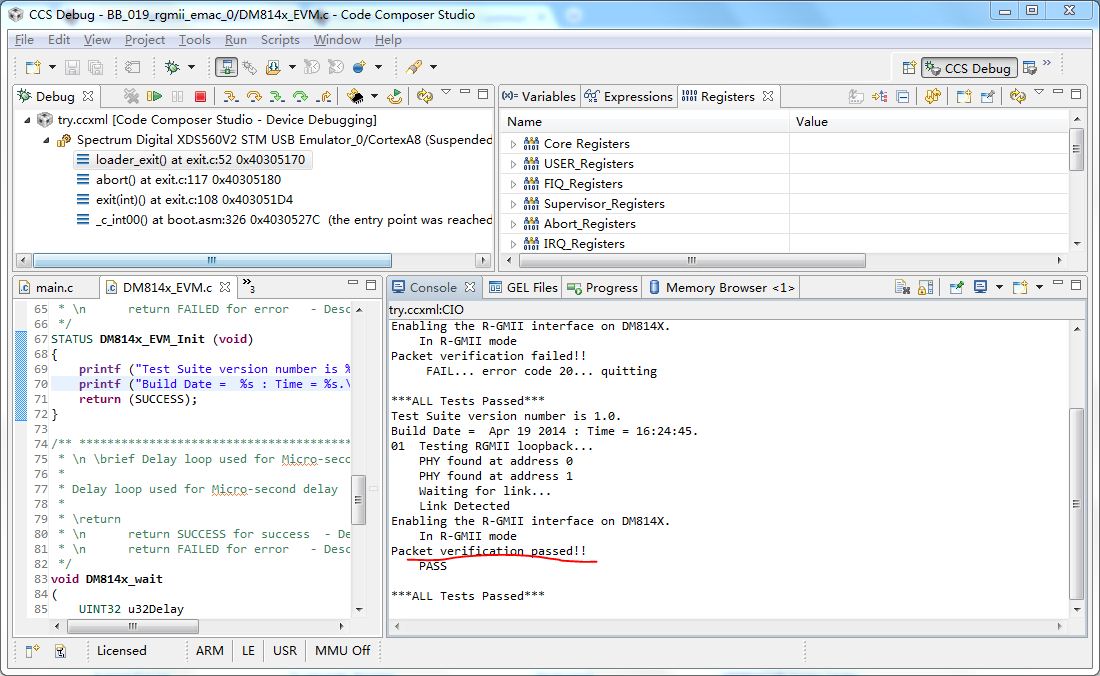

  • Test Suite version number is 1.0.
    Build Date = Apr 21 2014 : Time = 09:59:14.
    01 Testing RGMII loopback...
    PHY found at address 0
    PHY found at address 1
    In RGMII mode
    Waiting for link...
    Link Detected
    Enabling the R-GMII interface on DM814X.
    In R-GMII mode
    Packet verification failed!!
    FAIL... error code 20... quitting
    ***ALL Tests Passed***

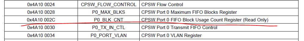

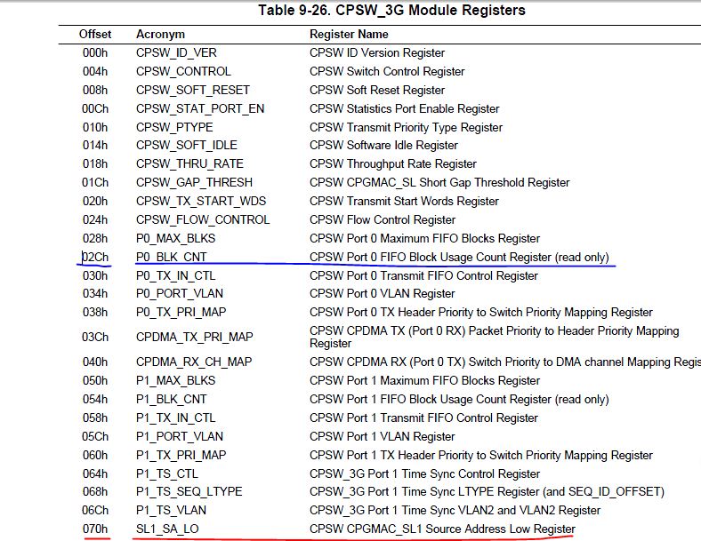

    But I can confirm there are wrong macro definitions in the emac.h.
    #define EMAC_STAT_PORT_EN        *( volatile UINT32* )( EMAC_BASE + 0x00C )
    #define EMAC_P0_FLOW_THRESH        *( volatile UINT32* )( EMAC_BASE + 0x01C )
    #define EMAC0_MACSRCADDRLO       *( volatile UINT32* )( EMAC_BASE + 0x02C )
    #define EMAC0_MACSRCADDRHI       *( volatile UINT32* )( EMAC_BASE + 0x030 )
    #define EMAC1_MACSRCADDRLO       *( volatile UINT32* )( EMAC_BASE + 0x04C )
    #define EMAC1_MACSRCADDRHI       *( volatile UINT32* )( EMAC_BASE + 0x050 )
    #define EMAC_P2_MAX_BLKS        *( volatile UINT32* )( EMAC_BASE + 0x054 )
    #define EMAC_P2_TX_PRI_MAP        *( volatile UINT32* )( EMAC_BASE + 0x064 )
    #define EMAC0_MACCONTROL         *( volatile UINT32* )( EMAC_BASE + 0x084 ) // Per EMAC
    #define EMAC0_MACSTATUS          *( volatile UINT32* )( EMAC_BASE + 0x088 ) // Per EMAC
    #define EMAC1_MACCONTROL         *( volatile UINT32* )( EMAC_BASE + 0x0C4 ) // Per EMAC
    #define EMAC1_MACSTATUS          *( volatile UINT32* )( EMAC_BASE + 0x0C8 ) // Per EMAC
    you can check these in the sprugz8e.pdf.
  • He Liang,
    This is the feedback from DM814x Mistral team:
    Please use the attached GEL file and follow the instruction in PG2.1_readme.txt available in "Baseboard\src\CCS_Test_code\Base_Board\rgmii_emac_0" to execute the test.
    As mentioned in the PG2.1_readme.txt, use the BB_019_rgmii_emac_0.out for executing the rgmii loopback test(Baseboard\src\CCS_Test_code\Base_Board\rgmii_emac_0\Debug\BB_019_rgmii_emac_0.out)
    Pavel
  • He Liang,
    I agree we have a mismatch between the Mistral emac.h file (0x064 -> EMAC_P2_TX_PRI_MAP) and DM814x TRM (0x064 -> P1_TS_CTL), but this should not be fatal for the test, as in the Mistral EMAC test, EMAC_P2_TX_PRI_MAP is set to 0x0, while in DM814x EZSDK u-boot P1_TS_CTL is not used at all.
    BR
    Pavel
  • I have compared the emac.h with 814X TRM, and I think these three definations are important to the test and they
    are different from TRM.
    EMAC0_MACCONTROL
    EMAC0_MACSRCADDRLO
    EMAC0_MACSRCADDRHI
    pls check this,.
    #define EMAC_BASE                0x4A100000
  • Finally, I made it by changing the macro defination of EMAC0_MACCONTROL.
    #define EMAC_SL1IDVER_BASE   EMAC_BASE + 0x700
    #define EMAC0_MACCONTROL         *( volatile UINT32* )( EMAC_SL1IDVER_BASE + 0x004 ) // Per EMAC
    #define EMAC0_MACSTATUS          *( volatile UINT32* )( EMAC_SL1IDVER_BASE + 0x008 ) // Per EMAC
    //#define EMAC0_MACCONTROL         *( volatile UINT32* )( EMAC_BASE + 0x084 ) // Per EMAC
    //#define EMAC0_MACSTATUS          *( volatile UINT32* )( EMAC_BASE + 0x088 ) // Per EMAC
    I try the mac level loopback and it is successful this time.
        EMAC0_MACCONTROL = 0
            | ( 0 << 9 )            // Round robin
            | ( 1 << 7 )            // Gigabit mode
            | ( 0 << 6 )            // TX pacing disabled
            | ( 0 << 5 )            // GMII RX & TX
            | ( 0 << 4 )            // TX flow disabled
            | ( 0 << 3 )            // RX flow disabled
            /* | ( 0 << 1 )*/         // Loopback disabled
           | ( 1 << 1 )             // Loopback enabled
            | ( 1 << 0 )           // full duplex
            | ( 1 << 22 )   // CEF
            | ( 1 << 23 );  // CSF
    and the log,
