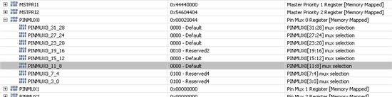

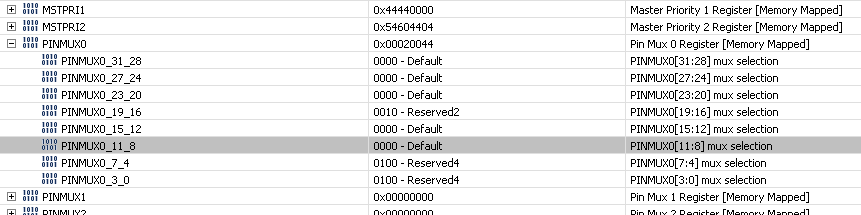

  • Problem was with pinmuxing. DSP must set PRU pins pinmuxing before giving control to PRU. I found this information from here http://caxapa.ru/thumbs/319913/PRUSS_Training_Slides.pdf page 16.
    PRU_R30[18], PRU_R30[19], PRU_R30[20] pins must be set in PINMUX0. With CCS 5.3 those registers are shown as Reserved, however they are really for PRU0 R30 pins.
    From C:\Program Files\Texas Instruments\pdk_C6748_2_0_0_0\C6748_StarterWare_1_20_03_03\include\hw\hw_syscfg0_C6748.h following defines can be found:
    #define SYSCFG_PINMUX0_PINMUX0_19_16_PRU0_R30_18 (0x00000002u)
    #define SYSCFG_PINMUX0_PINMUX0_7_4_PRU0_R30_19 (0x00000004u)
    #define SYSCFG_PINMUX0_PINMUX0_3_0_PRU0_R30_20 (0x00000004u)
    It now works for me.
