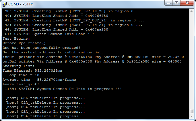

  • Hi Badri,
        I find I have made a mistake, the output memory addresses in my previous post are virtual address.  This time, I checked their actual physical addresses by using the Vsys_alloc() and printing them out:
        Vsys_allocBuf(1, WIDTH * HEIGHT, 128, &pInBuf);
        Vsys_allocBuf(1, WIDTH * HEIGHT / 16 * 5, 128, &pOutBuf);
        inBufDesc->numBufs = 1;
        inBufDesc->descs[0].buf = pInBuf.virtAddr;
        inBufDesc->descs[0].bufSize = (WIDTH * HEIGHT);
        outBufDesc->numBufs = 1;
        outBufDesc->descs[0].buf = pOutBuf.virtAddr;
        outBufDesc->descs[0].bufSize = (WIDTH * HEIGHT / 16 * 5);
         However, the performance is as poor as the result in my first test.
         This time, I think these buffer pointers are set correctly, as their physical address are indeed located at 0x90000000~0xA0000000.  And also, the correlated MAR bit are setting to 0xFFFFFFFF.  It that enough to say my cache are are set correctly?  Or, is there any options I should configure to ensure my cache enabled?
         Looking forward to your reply, sincerely I am.
    Naroah

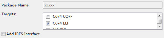

  • Hi Badri,
        The only part that my algorithm employed memTab is that
    Int XXX_XX_alloc(const IALG_Params *algParams,
        IALG_Fxns **pf, IALG_MemRec memTab[])
        memTab[0].size = sizeof(XXX_XX_Obj);
        memTab[0].alignment = 0;
        memTab[0].space = IALG_EXTERNAL;
        memTab[0].attrs = IALG_PERSIST;
        And I didn't use the IRES interface when I tried to generate this algorithm by GenAlg Wizard.
        I didn't check the "Add IRES Interface" box.
        Moreover, my algorithm was an In-place one.  At least, I have never try to allocate a large chunk of memory in my algorithm. Only some temporary variables and small arrays (<64B) are used.

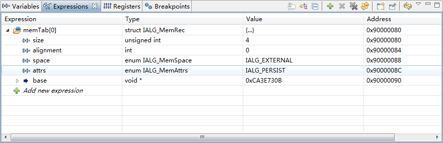

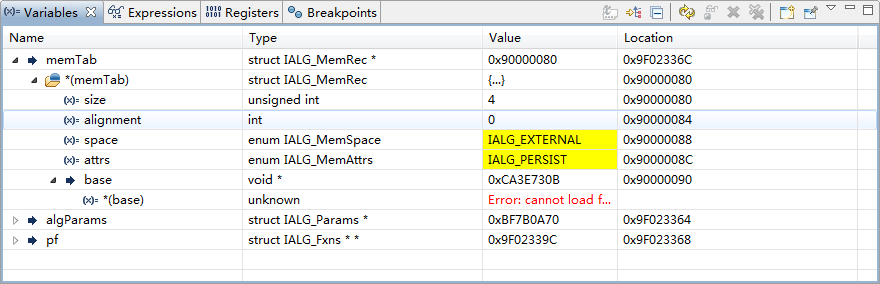

  • Ok then print the address of your memTab[0] buffer and confirm it is in cached memory region.
  • Hi Badri,
        By using the XDS100v2 via CCSv5.50, linking the C6xdsp, I step into the fxn: "XXX_XX_alloc()" and go through the fxn, getting some information from the watch window as below:
     And these below are for memTab[0]:
        According to these results, it seems that memTab locates @ 0x9000_0000~0xA000_0000, say, the SR1, which is cache enabled by MAR128_159 = 0xFFFFFFFF.
    Naroah
    Nov/27/2013

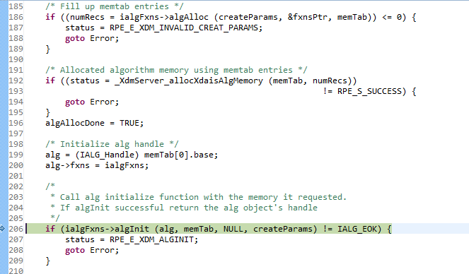

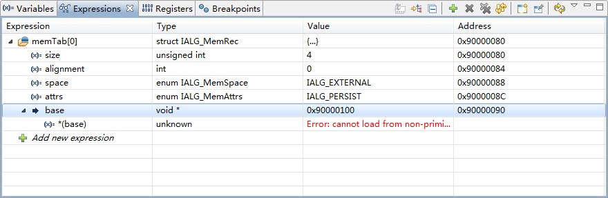

  • You should see value of base which has address 0xCA3E7308.When was the screen shot taken ? Is it after allocation of memTab memory ?
  • This screen shot has been taken before the program readys to run "return(1)" in the "XXX_XX_alloc()".
    What the value of base for?
  • Hi Badri,
        Ok, I know what you mean:
        When the alloc() fxn returns, xdm_server.c would set the alg handle by refering to memTab[0].base.  So this time, I get the C6x core running though these lines and get another snap:
        Now, I have got the information of memTab[0].base, which locates at 0x9000_0090 with the value 0x9000_0100.
    Nov/27/2013
    Naroah
  • Hi Badri,
        Thank you for your generous help!  And I have this problem solved!
        Yes, you are right.  It is definately a cache problem although the bug is "cached"/hidden in the dark part of my cupboard.
        Although the inBufDesc->desc[0].buf and someelse like memTabs etc. are correctly cached in my algorithm, an argument Tab, which declared in my InArgs structure, is frequently accessed by the kernel part my algorithm.  By using the emulator to check these paramters, I find the InArgs is located @ BFXX_XXXX, say, SR0, non cached by DSP.
        Rearranging my code and reallocating memory for these args in SR1, I got my algorithm running as fast as it did in EZSDK!
