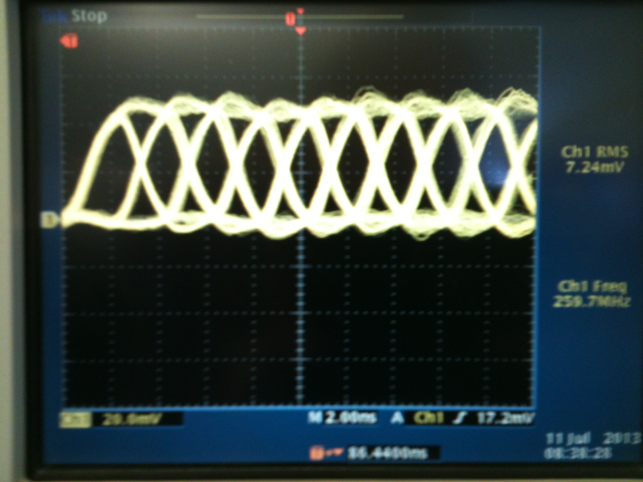

    I read through that doc and I think we followed these design techniques very closely. We have many high speed designs that work properly including USB 2.0, FireWire, and SDI video running at 3Gb/s. We have controlled impedances specified in our PCB stackup and routed these very short USB 2.0 traces with arcs. I also have a picture from an oscilloscope showing a very clean eye diagram of this USB 2.0 signal. I know I can't rule out a hardware issue but I am hard pressed to figure out what it is right now.
    If we can pursue this further I will greatly appreciate the help.

    - First: can you double check your entire USB clocking tree? I've seen issues before where our "programmed" (expected) input clock is different from the actual input clock which resulted in bit errors at HS but not LS/FS.
    - Second: any chance you can borrow/rent a USB Electrical Compliance rig? This is comprised of a scope with the USB Electrical Certification package installed and a USB break-out board (SQUIDD). This ten minute test would answer many questions.

    Your thought of checking the clock tree got us to review clock related items - thanks.  I want to post what we finally did to fix these USB issues so that someone else may benefit.
    I fixed the problems with USB for both u-boot and linux.  The short version of the story is that I needed to set the #define V_OSCK to the oscillator value we are using (25 MHz) in uboot’s include/configs/am335x_evm.h file.  It had been set to the eval board value (24 MHz).  We are using the AM335X SDK 05.06 eval board code as a template.
    When you look at uboot's /arc/arm/include/asm/arch-am33xx/clocks_am33xx.h, you can see that the USB Phy clock is derived directly from V_OSCK.  So I can see why we experienced USB problems within u-boot.
    But it looks to me like linux gets the system oscillator value by reading the 2 assigned sysboot pins, then adjusts all the clock-related fields dynamically at startup (including setting the peripheral PLL register values, needed to generate the USB Phy clock).  We did have these pins set correctly for 25 MHz.  And at linux startup the console log showed a sys clock of 25 MHz.
    I am surprised that changing V_OSCK value in u-boot DID fix our linux USB problem, but also am glad that this issue is now fixed.
