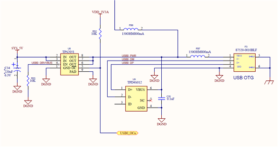

    I am using the Beaglebone Black USB1 OTG hardware (only I have connected the hardware to USB0 on the AM3356), I have floated the USB0_ID pin to force USB0 to act as Peripheral.
    I have included a schematic of the hardware below, are there any changes I need to make to the circuit in order to make it work properly?
  • Hardware seems fine to me. I suppose the vertical wire on top goes to USB0_VBUS, is this correct?
  • That's correct, the virtical wire goes to USB0_VBUS. I've gone through the hardware quite a bit, but I don't see where the issue is comming from. The schematic above should be identical to the Beaglebone Black USB0 schematic, minus the mini-B connector.

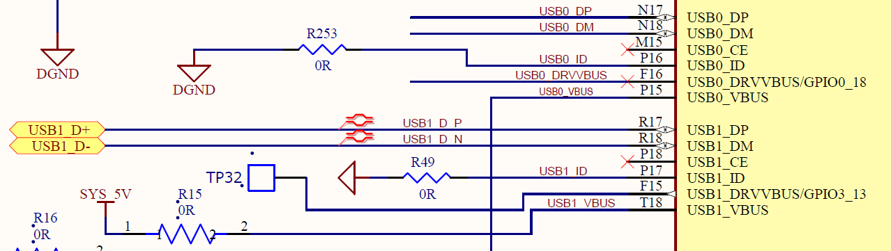

  • Also can you please show the USB0 pins on the AM335x? is there any cap on VBUS line?

    Please see the below schematic, note that R253 has been removed to allow the ID pin to float, thus forcing USB0 as peripheral. USB0_VBUS is the same line going down from the previous schematic, there is no cap on the VBUS line, as per the Beaglebone Black schematic.
