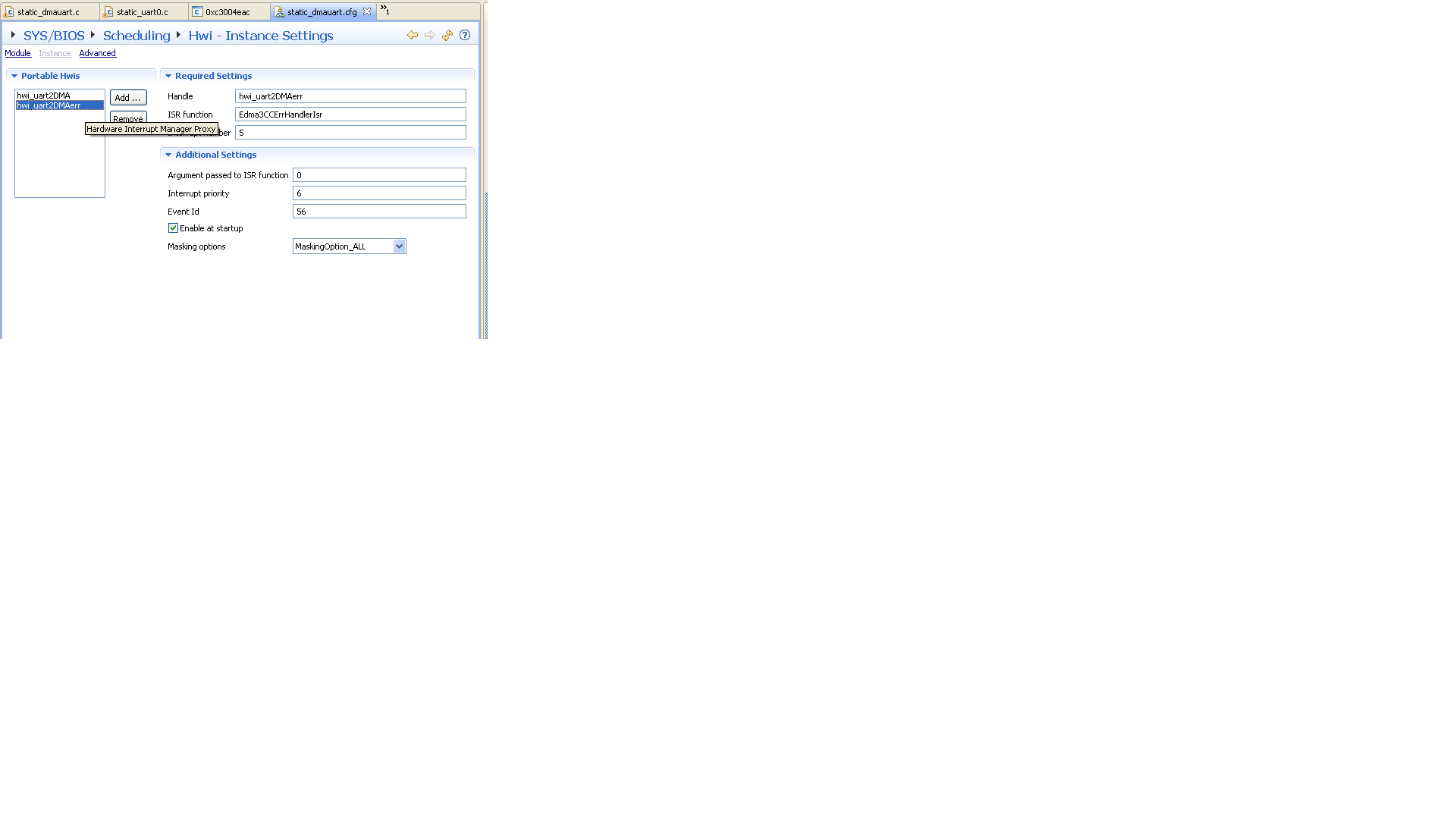

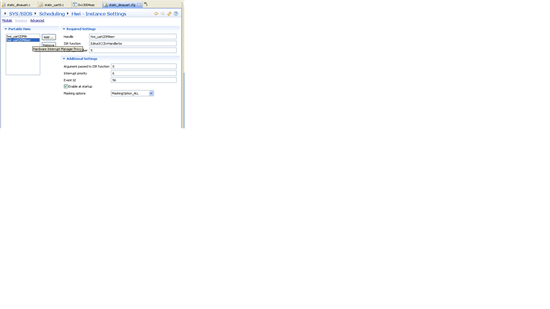

I want to port Uart EDMA Starterware project to SYSBIOS 6 on OMAP L138 LCDK (CCS 5.4). The code in Startware of this example first sends out a string:
volatile char enter[] = "\r\nPlease Enter 20 bytes from keyboard\r\n";
After I modify interrupt initialization:
/* Function to register EDMA3 Interrupts */
static void ConfigureIntEDMA3(void)
/* Register Interrupts Here */
#ifdef _TMS320C6X
// IntRegister(C674X_MASK_INT4, Edma3ComplHandlerIsr);
IntRegister(C674X_MASK_INT7, Edma3ComplHandlerIsr);
IntRegister(C674X_MASK_INT5, Edma3CCErrHandlerIsr);
// IntEventMap(C674X_MASK_INT4, SYS_INT_EDMA3_0_CC0_INT1);
IntEventMap(C674X_MASK_INT7, SYS_INT_EDMA3_0_CC0_INT1);
IntEventMap(C674X_MASK_INT5, SYS_INT_EDMA3_0_CC0_ERRINT);
// IntEnable(C674X_MASK_INT4);
IntEnable(C674X_MASK_INT7);
IntEnable(C674X_MASK_INT5);
/* Function used to Initialize EDMA3 */
static void EDMA3Initialize(void)
/* Enabling the PSC for EDMA3CC_0.*/
PSCModuleControl(SOC_PSC_0_REGS, HW_PSC_CC0, PSC_POWERDOMAIN_ALWAYS_ON,
PSC_MDCTL_NEXT_ENABLE);
/* Enabling the PSC for EDMA3TC_0.*/
PSCModuleControl(SOC_PSC_0_REGS, HW_PSC_TC0, PSC_POWERDOMAIN_ALWAYS_ON,
/* Initialization of EDMA3 */
EDMA3Init(SOC_EDMA30CC_0_REGS, EVT_QUEUE_NUM);
** Enable AINTC to handle interrupts. Also enable IRQ interrupt in
** ARM processor.
SetupInt();
/* Register EDMA3 Interrupts */
ConfigureIntEDMA3();
/* Function used to Setup ARM Interrupt Controller */
static void SetupInt(void)
#ifdef _TMS320C6X
// Initialize the DSP Interrupt controller
IntDSPINTCInit();
// Enable DSP interrupts globally
IntGlobalEnable();
#else
/*Initialize the ARM Interrupt Controller(AINTC). */
IntAINTCInit();
/* Enable IRQ in CPSR.*/
IntMasterIRQEnable();
/* Enable the interrupts in GER of AINTC.*/
IntGlobalEnable();
/* Enable the interrupts in HIER of AINTC.*/
IntIRQEnable();
#endif
The console receives some erroneaous words, although I can tell several words such as ease  key (which are obvious from the original string).
The original Starterware project EDMA3 use 2 interrupts (INT4, INT5). Due to confilicts with SYSBIOS, I change INT4 to INT7 as:
What is wrong with my code? Thanks

  • Excuse me. I forget to add the two interrujpts configurations. Here are they
    Are they right?
