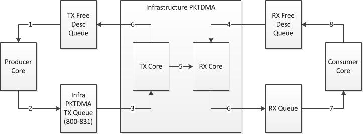

  • Daniel,
    For your RX flow configuration what do you have the RX_ERROR_HANDLING bit set to? If you have this bit set to 1 then any starvation errors at your RX free descriptor queue will cause the packet transfer to be retried after a TIMEOUT period has elapsed. This can cause the descriptor to be popped from your TX queue by the infrastructure PKTDMA but not returned to the TX free descriptor queue. The packet will also not arrive at the destined RX queue.
    See the image below for the series of steps that take place during an infrastructure transfer. If there are no packets available in the RX Free Descriptor Queue at step 4 then starvation will occur and the packet popped during step 3 will either be recycled back to the TX Free Descriptor Queue (RX_ERROR_HANDLING = 0) or the packet will be held during the TIMEOUT period until the RX Free Descriptor Queue is checked once again for a descriptor (RX_ERROR_HANDLING = 1). When you get stuck in your error state can you check the number of descriptors on each of the 4 queues below (this can be done through register reads in the memory browser view in CCS)? This should give us an idea of what is going wrong. It could be the case that there is some sort of condition where the Consumer Core is not returning descriptors back to the RX Free Desc Queue fast enough and is causing a starvation to occur.
    1) The producer core has data to transfer to another core so it pops a free descriptor from the TX Free Descriptor Queue and attached the buffer
    2) The producer core then pushes that descriptor onto Infra PKTDMA TX Queue to begin the transfer
    3) The Infrastructure PKTDMA sees a descriptor on its TX queue so the TX Core pops the descriptor to start moving the data
    4) The TX Core notifies the RX Core that data is coming so the RX Core pops a descriptor from the RX Free Descriptor Queue specified by the RX Flow being used
    5) The Infrastructure PKTDMA transfers the data from the TX buffer to the RX buffer
    6) After the data transfer is completed the TX Core returns the descriptor that it popped back to queue specified by the return queue field in the descriptor. Also after the transfer is complete the RX Core pushes the descriptor with the newly filled buffer to the RX Queue that was specified by the RX Flow
    7) The Consumer Core pops a descriptor from the RX Queue and consumes the data
    8) Once the Consumer Core is finished with the data then the descriptor is returned to the RX Free Descriptor Queue

        rxFlowCfg.rx_src_tag_lo_sel     =   0;
        rxFlowCfg.rx_src_tag_hi_sel     =   0;
        rxFlowCfg.rx_size_thresh0_en    =   0;    // By default, we disable Rx Thresholds
        rxFlowCfg.rx_size_thresh1_en    =   0;    // By default, we disable Rx Thresholds
        rxFlowCfg.rx_size_thresh2_en    =   0;    // By default, we disable Rx Thresholds
        rxFlowCfg.rx_size_thresh0       =   0x0;
        rxFlowCfg.rx_size_thresh1       =   0x0;
        rxFlowCfg.rx_size_thresh2       =   0x0;
        rxFlowCfg.rx_fdq0_sz0_qmgr      =   rxFreeQInfo.qMgr; // Setup the Receive free queue for the flow
        rxFlowCfg.rx_fdq0_sz0_qnum      =   rxFreeQInfo.qNum;
        rxFlowCfg.rx_fdq0_sz1_qnum      =   0x0;
        rxFlowCfg.rx_fdq0_sz1_qmgr      =   0x0;
        rxFlowCfg.rx_fdq0_sz2_qnum      =   0x0;
        rxFlowCfg.rx_fdq0_sz2_qmgr      =   0x0;
        rxFlowCfg.rx_fdq0_sz3_qnum      =   0x0;
        rxFlowCfg.rx_fdq0_sz3_qmgr      =   0x0;
        rxFlowCfg.rx_fdq1_qnum          =   rxFreeQInfo.qNum;  // Use the Rx Queue to pick descriptors
        rxFlowCfg.rx_fdq1_qmgr          =   rxFreeQInfo.qMgr;
        rxFlowCfg.rx_fdq2_qnum          =   rxFreeQInfo.qNum;  // Use the Rx Queue to pick descriptors
        rxFlowCfg.rx_fdq2_qmgr          =   rxFreeQInfo.qMgr;
        rxFlowCfg.rx_fdq3_qnum          =   rxFreeQInfo.qNum;  // Use the Rx Queue to pick descriptors
        rxFlowCfg.rx_fdq3_qmgr          =   rxFreeQInfo.qMgr;
        // Configure the Rx Command flow
        if ((gRxCommandFlowHnd[g_uiCoreNum] = Cppi_configureRxFlow (gCpdmaHnd, &rxFlowCfg, &isAllocated)) == NULL)
            #ifdef EVM
            System_printf ("Error configuring command Rx flow \n");
    		#endif
            return -1;
        SYS_CACHE_WB ((void *)gRxCommandFlowHnd, 128, CACHE_FENCE_WAIT);
        // Configure the Rx Command flow for QMSS
        if ((gRxQmssCommandFlowHnd = Cppi_configureRxFlow (gQmssCpdmaHnd, &rxFlowCfg, &isAllocated)) == NULL)
            #ifdef EVM
            System_printf ("Error configuring command Qmss Rx flow \n");
    		#endif
            return -1;
        // Setup Ethernet Rx Flow on each core. The only difference among the cores is the rxQInfo.
        // A Rx flow encapsulates all relevant data properties that CPDMA would
        // have to know in order to succefully receive data.
        // Initialize the flow configuration
        memset (&rxFlowCfg, 0, sizeof(Cppi_RxFlowCfg));
        rxFreeQInfo = Qmss_getQueueNumber (gRxEthernetFreeQHnd[g_uiCoreNum]);
    	#ifdef EVM
        System_printf ("Rx Free ethernet descriptor queue = %d\n",gRxEthernetFreeQHnd[g_uiCoreNum]);
    	#endif
        // Let CPPI pick the next available flow
        rxFlowCfg.flowIdNum             =   CPPI_PARAM_NOT_SPECIFIED;
        rxFlowCfg.rx_dest_qmgr          =   rxQInfo.qMgr;
        rxFlowCfg.rx_dest_qnum          =   rxQInfo.qNum;
        rxFlowCfg.rx_desc_type          =   Cppi_DescType_HOST;
        rxFlowCfg.rx_sop_offset         =   0;
        rxFlowCfg.rx_ps_location        =   Cppi_PSLoc_PS_IN_DESC;
        rxFlowCfg.rx_psinfo_present     =   0;    // Disable PS info
        rxFlowCfg.rx_error_handling     =   0;    // Drop the packet, do not retry on starvation by default
        rxFlowCfg.rx_einfo_present      =   1;    // EPIB info present
        rxFlowCfg.rx_dest_tag_lo_sel    =   0;    // Disable tagging
        rxFlowCfg.rx_dest_tag_hi_sel    =   0;
        // Configure the Rx Ethernet flow
        if ((gRxEthernetFlowHnd[g_uiCoreNum] = Cppi_configureRxFlow (gCpdmaHnd, &rxFlowCfg, &isAllocated)) == NULL)
            #ifdef EVM
            System_printf ("Error configuring Ethernet Rx flow \n");
    		#endif
            return -1;
        SYS_CACHE_WB ((void *)gRxEthernetFlowHnd, 128, CACHE_FENCE_WAIT);
        // All done with Rx configuration. Return success.
        return 0;
    Daniel
