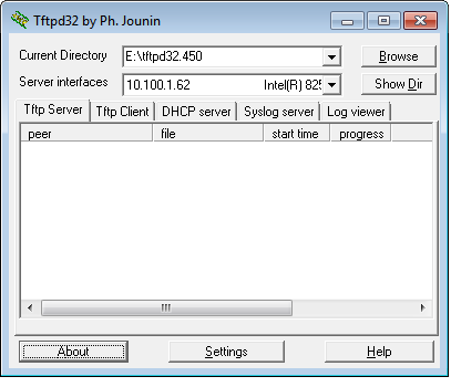

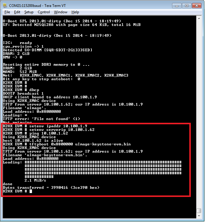

  • Hi Lawrence,
    Yes, it is possible to load the images in the windows environment provided the tftp server is running on the windows.
    Hardware Setup:
    Connect the Ethernet cable, UART-USB and power cable to K2H EVM.
    Steps:
    0. On windows side, run the tftp server. ( Attached the zip file)
    1. Power on reset ( For me, I have choosen the SPI boot mode)
    2. Observe the boot messages on the teraterm
    3. Hit any key to stop the auto boot
    4. Set the ip address for the target board
        K2HK EVM # dhcp
    ( Note down the ip address )
        K2HK EVM # setenv ipaddr 10.100.1.9
    5. Set the server ip address.
        K2HK EVM # setenv ipaddr 10.100.1.62
    6. Using ping command check the connectivity.
        K2HK EVM # ping 10.100.1.62
    7. Copy the binary image into the folder from which you are running the tftp server.
    8. Uisng tftpboot, transfer theimage.
        K2HK EVM # tftpboot 0x8800000 uImage-keystone-evm.bin
    9. You are done!!!!!

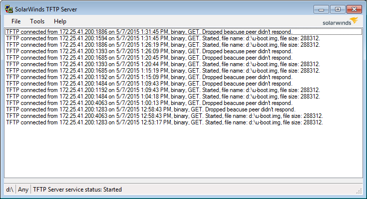

  • The customer is still having problems.  This is what they are seeing:
    TCI6638 EVM # setenv ipaddr 172.25.41.200
    TCI6638 EVM # setenv netmask 255.255.255.0
    TCI6638 EVM # setenv serverip 172.25.41.195
    TCI6638 EVM # setenv gatewayip 172.25.41.193
    TCI6638 EVM # saveenv
    Saving Environment to NAND...
    Erasing Nand...
    Erasing at 0x120000 -- 100% complete.
    Writing to Nand... done
    TCI6638 EVM # ping 172.25.41.193
    Using TCI6638_EMAC1 device
    host 172.25.41.193 is alive
    TCI6638 EVM # ping 172.25.41.195
    host 172.25.41.195 is alive
    TCI6638 EVM # tftp 0xc300000 u-boot.img
    Using TCI6638_EMAC device
    TFTP from server 172.25.41.195; our IP address is 172.25.41.200
    Filename 'u-boot.img'.
    Load address: 0xc300000
    Loading: T T T T T T T T T T T T T T T T T T T T T T T T T T T T T T T T T T T T T T T T T T T T T T T T T T T T T T T T T T T T T T T T
    Retry count exceeded; starting again
    Any suggestion?
    Lawrence

  • Customer has tried using tftpd64 on another machine.  They have used TFTP on other non-TI boards.  So I believe thier setup is correct.  This is their first TI board.   Would there be a reason for TFTP to fail due to the file it recieve? Customer is trying to run VxWorks so they need to change uboot file.
    Lawrence
    Which MCSDK version customer is using ?
    Ask them to use latest MCSDK and prebuilt images.
  • Hi, Lawrence,
    Tftpd64 server needs to have PXE compatibility enabled.
    Rex
