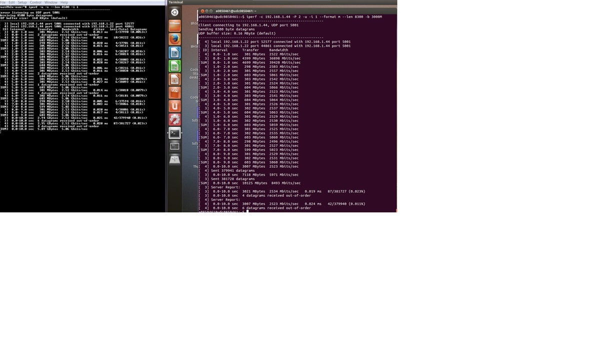

  • Did you tested K2H with RTM-BOC by iperf?
    I did same test as you did. but max TX throughput was only below 2.0 Gbits (TCP/UDP) without packet loss.
    To be more specific, There is no packet loss in UDP bandwidth 5 Mbits,
    but about 33% packet loss is occurred in 30 Mbits bandwidth.
    the test result is very poor under K2H with host PC(x86) environment. (attached file.)
    Could you share here your test result by running iperf?
    I want to see high performance with K2H's 10Ge interface.

  • Hi, MinKeun,
    With jumbo packet enabled, I can get around 6Gbps inbound which is similar to what we get on K2E as well. That is 6Gbps ingress and 7.6Gpbs egress. I didn't play around with the packet sizes. I may be able to squeeze a few tens mb more by tuning it.
    ~$ iperf -c 192.168.1.44 -P 2 --format m -u -b 3000M --len 8300 -t 100
    Client connecting to 192.168.1.44, UDP port 5001
    Sending 8300 byte datagrams
    UDP buffer size: 0.16 MByte (default)
    [  4] local 192.168.1.22 port 58805 connected with 192.168.1.44 port 5001
    [  3] local 192.168.1.22 port 57479 connected with 192.168.1.44 port 5001
    [ ID] Interval       Transfer     Bandwidth
    [  4]  0.0-100.0 sec  35915 MBytes  3013 Mbits/sec
    [  4] Sent 4537360 datagrams
    [  3]  0.0-100.0 sec  35910 MBytes  3012 Mbits/sec
    [  3] Sent 4536656 datagrams
    [SUM]  0.0-100.0 sec  71825 MBytes  6025 Mbits/sec
    [  3] WARNING: did not receive ack of last datagram after 10 tries.
    [  4] WARNING: did not receive ack of last datagram after 10 tries.

  • Hi, MinKeun,
    At around 5Gbps throughput, the rx packet loss rate is less than 0.02%.

  • Hi Rex.
    prebuilt dtb file on MCSDK 3.1.3.6 is not operating because xge(eth4/5) interfaces are not activated.
    so, i used a dtb file which is made according to below link.
    http://processors.wiki.ti.com/index.php/MCSDK_UG_Chapter_Exploring#Enabling_10Gig_Ethernet_Driver_Device_Tree_Bindings
    jumbo frame is enabled on both side. (ip link set ethN mtu 9000)
    iperf application differed from yours. (i did test by using iperf3)
    test result be pretty similar as you did so long as i used iperf which is on the k2e file system.
    well, small udp packet loss during rx is still there regardless of decreasing bandwidth or packet length.
    there is no packet loss in case my host PC is receiving, and target is sending.
    (this test's bandwidth is set to 100Mb on purpose.)
    but in case counter direction, small packet loss is occurred.
    could you confirm this situation is appeared also your test environment?
    if the result is same, i want to know where packets lose.
