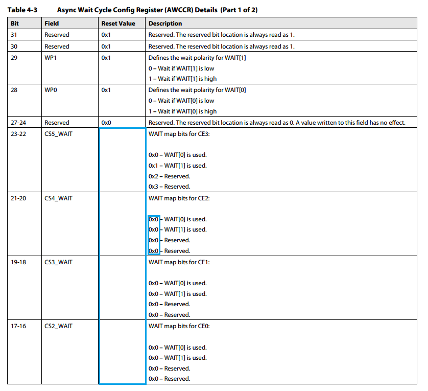

I am trying to use EMIF16 interface,
the EMIF document of 66AK2E05 doesn't tell the reset value of  'WAIT map bits for CEx',
could you tell me what the default value is?
And is there a problem of the info below ?
0x0 WAIT[0] is used.
0x0 WAIT[1] is used.
0x0 Reserved.
0x0 Reserved.
Any help on this will be appreciated.
